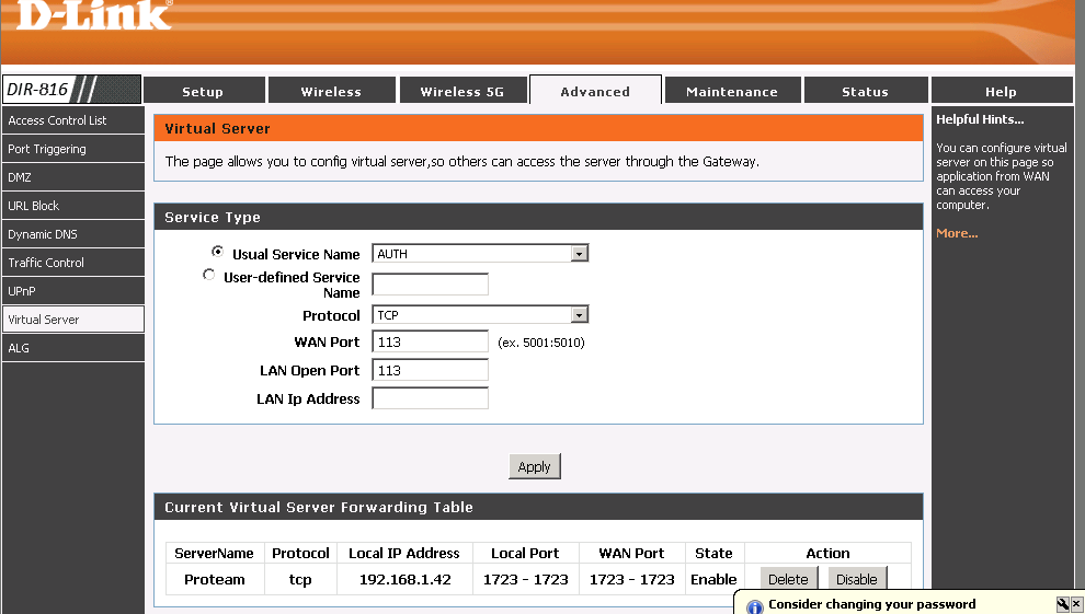

Can you pls find this attachment file.

How do you have your VPN server configured right now? More often than not, once I opened that port, it was usually something on the server I needed to tweak to get things working.

PS- Looking at the manual there is an "ALG" tab below virtual server where you can enable PPTP pass-through.  This is usually for outgoing connections but I would enable if not already done.
