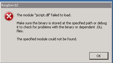

Try running the following command from an Administrative command prompt:
regsvr32.exe jscript.dll

Abraham Deutsch
I copied and registered successful. but still not showing and services (maybe need to register %SystemRoot%\SysWOW64 for 64-bit or maybe a restart, please advice)

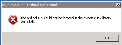

Error I get when I tried to reinstall IE, at the end of the installation when it says starting programs I get the following error 139.JPGNo strange things during the normal course of using the desktop or during boot up, but error msg no iertutil.dll found I already passed it, but when trying to register it I get the following msg IE.JPGRoles DHCP, DNS, File/disk storage management, Group policy management.

Abraham Deutsch
it_saige as you predicted I had already run sfc /scannow and did not help
tried to install IE 8 but got msg this system does not support IE 8 although I selected the download for window server 2008)

Abraham Deutsch

Abraham Deutsch
I have the iertutil.dll but when trying to register it I get error msg as send image above
