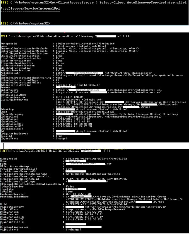

The problem I am having is that when I run:
Get-ClientAccessServer | Select-Object AutoDiscoverServiceInternalUri
I get a blank result as seen in the first command in the screenshot below.
Can you you please provide me a way to "roll back" if something goes bad.
I want to cover all my bases before we go-live if possible.
More details:
EMS_Commands
Thanks in advance!
