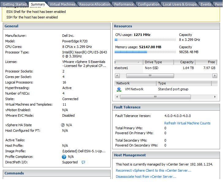

Could you screenshot the datastore summary.
E White
Data Store Summary
James Murphy
E White
Data Store Summary
okay so there is datastore called datastore1, 1.64TB I cannot see the capacity....
and if you hit Power On ?
E White
Try this Summary
E White
I powered it on, it finally came on, but only have 7.97 GB available.
