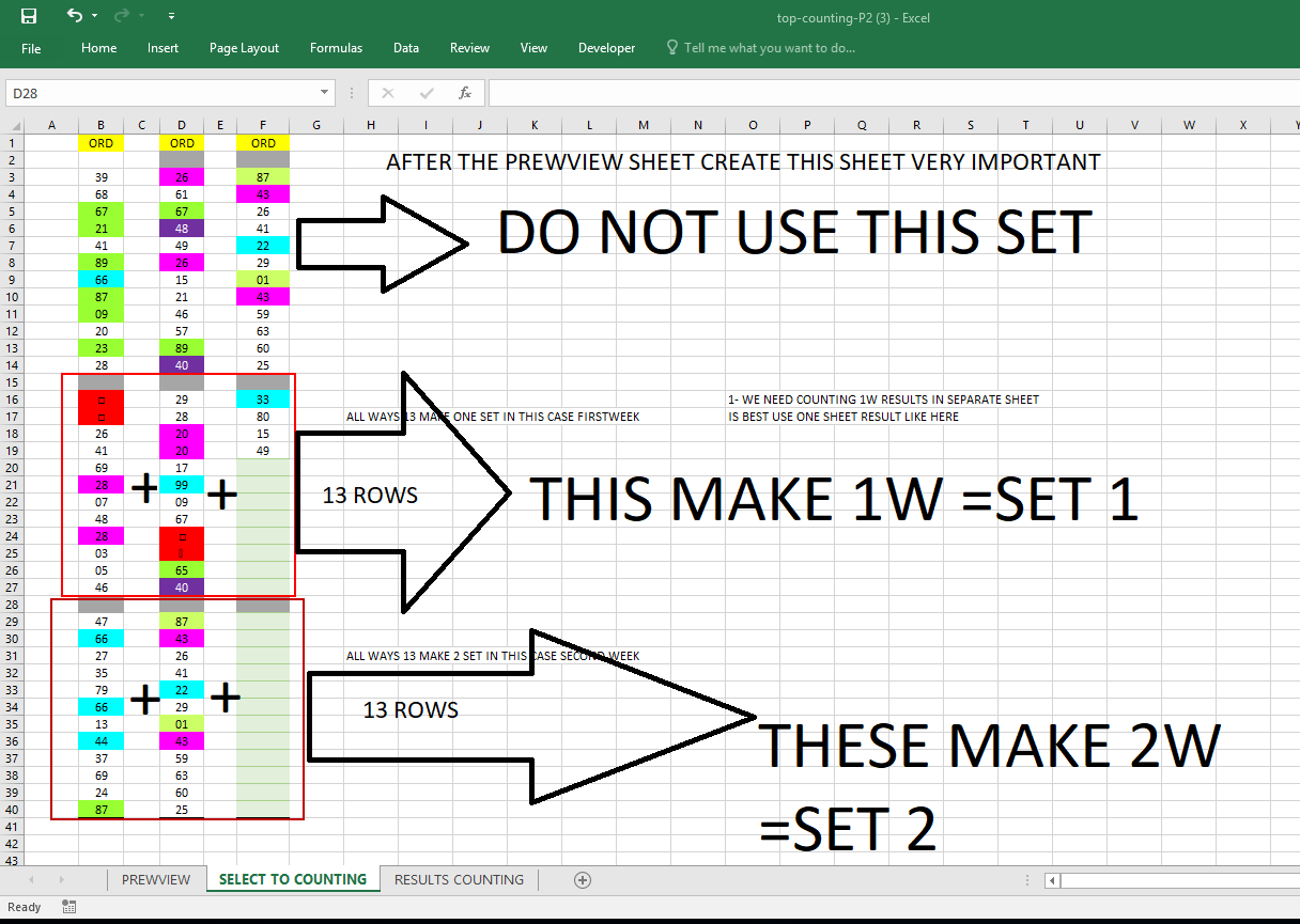

need counting specific data on sheet
need to count this numbers in this order
counting
any help please?

ADRIANA P
Roy_Cox SURE ! HERE IS!
DATA
Roy Cox
That's a picture, a workbook is what's needed

ADRIANA P
Martin the color show make more clear to see the numbers because they a lot in the view
so make more easy
so make more easy
Ok, if you need them, I'm willing to modify the code to add them, but to do so I'll need to understand why they have the colors they do. In other words tell me something like cell G17 is green because....
Ok, si los necesita, estoy dispuesto a modificar el código para agregarlos, pero para hacerlo necesitaré entender por qué tienen los colores que hacen. En otras palabras, dígame algo como la celda G17 es verde porque ....

I want to make it easy. Tell me why the cell is green and I'll make it green.
Quiero que sea fácil. Dime por qué la celda es verde y lo haré verde.

Here's an update that adds the teal (trullo azul) color.
29019372a.xlsm

Is a lot of code  i know is not easy !
TO MAKE IT HAPPENS !
that the reason a recomend to used the SELECT TO COUNTING sheet
so you have it summarize  for esay work in
Martin Liss
Actually, the SELECT TO COUNTING sheet doesn't help at all. It is just a copy of the ORD columns from the "PREWVIEW" sheet, and so the only difference in the code would be the name of the sheet where the columns are (and different column letters).
En realidad, la hoja SELECT TO COUNTING no ayuda en absoluto. Es sólo una copia de las columnas ORD de la hoja "PREWVIEW", por lo que la única diferencia en el código sería el nombre de la hoja donde se encuentran las columnas (y las diferentes letras de columna).
Martin Liss
New version with full color formatting!
Changes include:
  • Corrected a problem with the MID column
  • Formatted all cells in the 1W, 2W and ALL columns to be 2 digits. In other words "1" will be "01"
  • Changed the way the teal color is produced. It now uses conditional formatting where perviously it didn't
  • Added conditional formatting for the blue cells
  • Added a sheet named "CF" which lets me to the conditional formatting
One last question. Why is cell B26 in your RESULTS COUNTING sheet purple. It's not conditional formatting.
29019372b.xlsm
