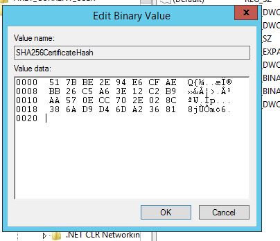

So I went to the registry, however when I click modify there is no option to change a value to 32. I attach screen shot of what comes up. Any ideas what I need to change?

Did you check the permissions?
burny1
Yes I changed it. That was when I was able to click on modify.
masnrock
Great. Restart the machine and then try connecting again... What happens?
