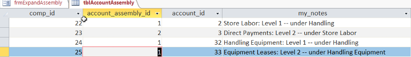

Functionally, my db works as expected, however, I have noticed that when creating my bill of accounts, the account levels are not synchronizing correctly.  See below:
In the above example, Level 3: 33-Equipment Leases should appear underneath Level 1: 32 Handling Equipment.
I have reviewed the article's sample database numerous times over but cannot seem to identify what I am doing wrong.

You have the account_assembly_ID as a "3" in the data.  Should be "1".
Normally when you enter a BOM like this "Flat", you specify:
parent assembly       line item      child element (which may or may not be an assembly itself).
so it looks like:
A                  1                      B
A                  2                      C
B                  1                       D
B                  2                       E
Result:
A
   B
      D
      E
   C
Jim.

So, I did as you suggested:
and ended up with this:
It should read as:
Thanks again,
~Tala~
You need to enter another assembly in the table then.
So the highlighted 1 would need to be 32.
Jim.
I see.. :-)
Being a simple kind of gal I couldn't quite grasp the concept of it all but I think I get it now!
Results are looking good:
