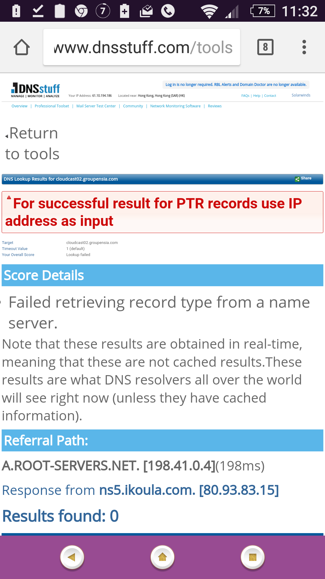

Jackie Man
1. Goto http://www.dnsstuff.com/tools
2. Under DNS Lookup, type the full URL your mail server hostname... say mail.domain.com
3. In the pull down menu of "Choose a DNS Record type" select MX, CNAME and PTR and click the blue triangle button next to the input field of the full URL your mail server hostname.

Jackie Man
Failed for PTR DNS lookup.
PTR

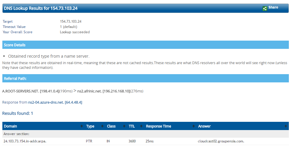

Jackie Man
Your DNS lookup for MX record is successful.
Do you ISP charge you for Reverse DNS setup?
Patrice Tano
No we are not charge for reverse DNS Setup.

Patrice Tano
PTR Record Exist
