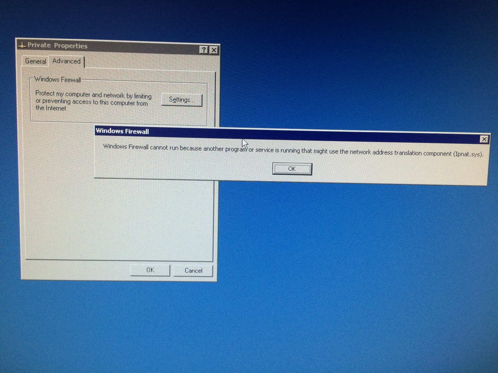

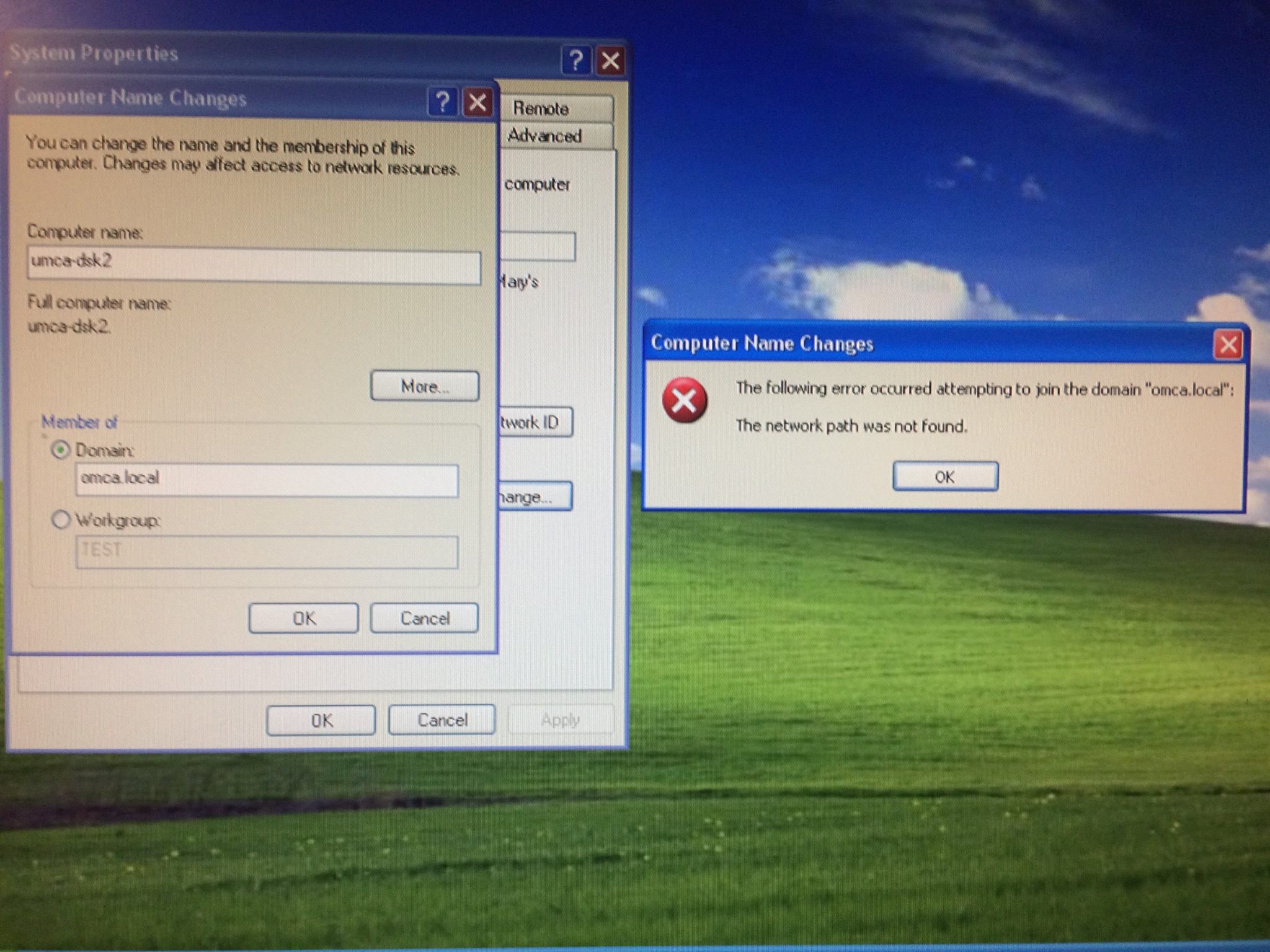

Network Connectivity issue. I can ping the DC which is the SBS 2003 Server by Name and IP Address from all of my computers and servers within my network and also RDP into the Server, but I cannot access any resource from the DC for ex: (shared drives, mapped drives, network printer, etc.). DC also host Exchange server 2003, but cannot access exchange from workstation using Outlook. Pretty much cannot access anything on my DC, however; from the DC I can access everything on all of my computers on the network. So definitely there is a connectivity issue on the DC itself. Please advice.

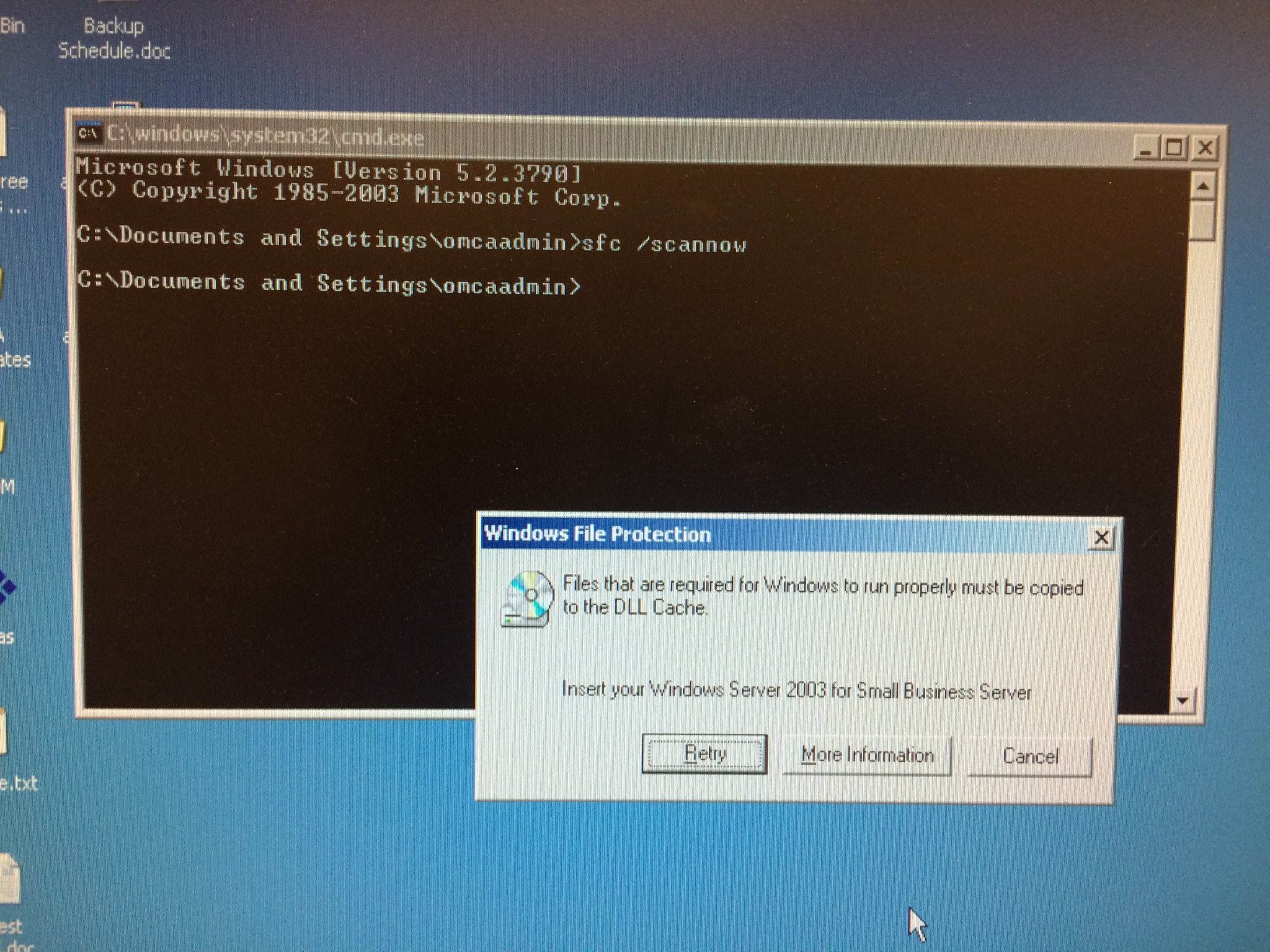

4 - SFC /scannow - see attach file - Keep in mind that I'm troubleshooting with RDP, not at the Server locally

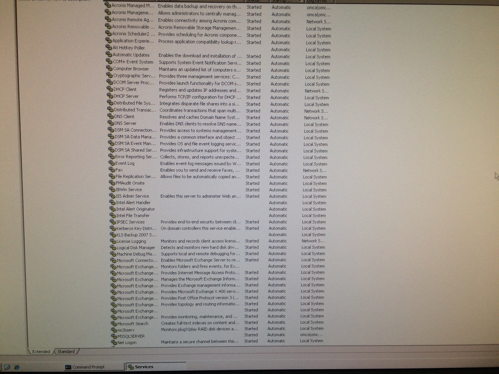

7 - Services - see attach file

You can try disabled the Firewall and/or Antivirus and test again so can know if the Firewall is blobking this actions. If it works, you have to start creating rules in your Firewall/Antivirus.

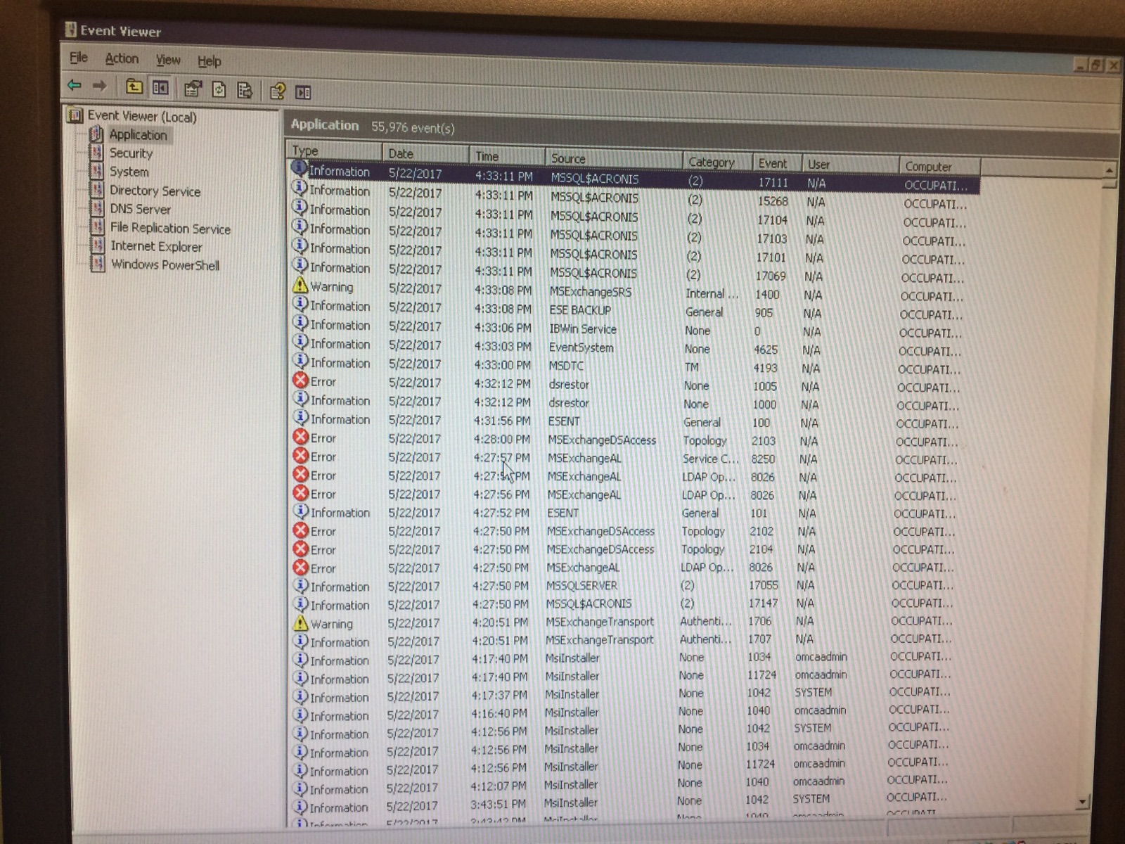

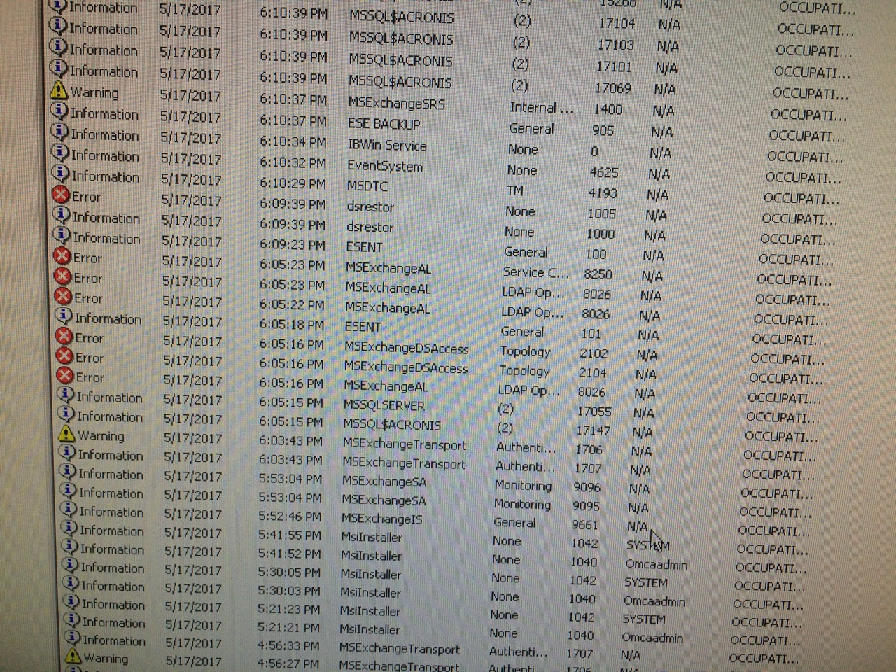

Does anything show in the Event Logs? I would also suggest to try removing Trend Micro as it can sometimes do weird things.

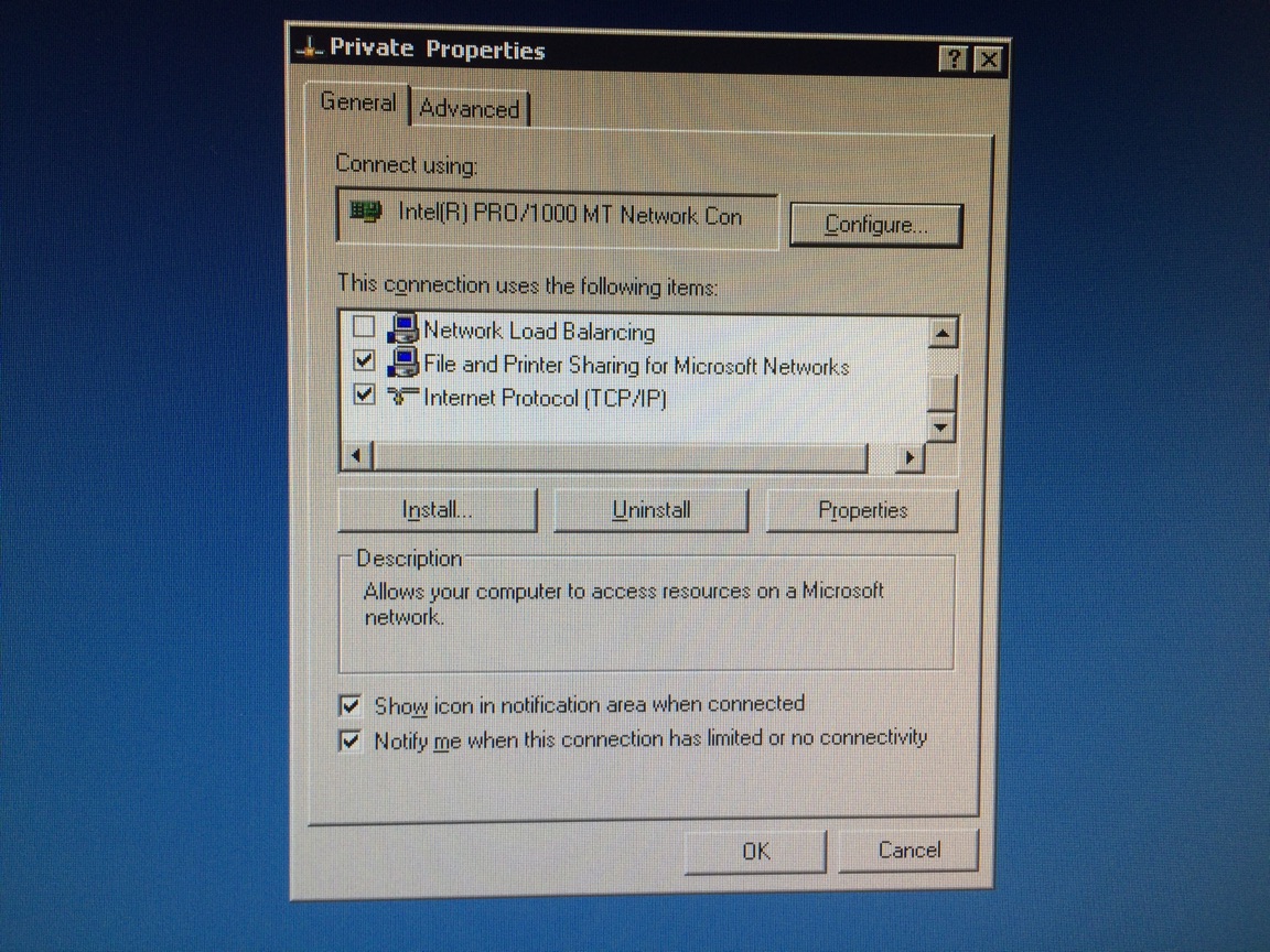

Out of curiosity if your run \\ServerName\ShareName on the SBS itself, can you browse the share.  If that works it may not be related to a service, but would sound more like a firewall or A/V issue.  I agree with masnrock, many folks moved away from Trend Micro specifically on SBS years ago, when still supported, due to numerous issues.

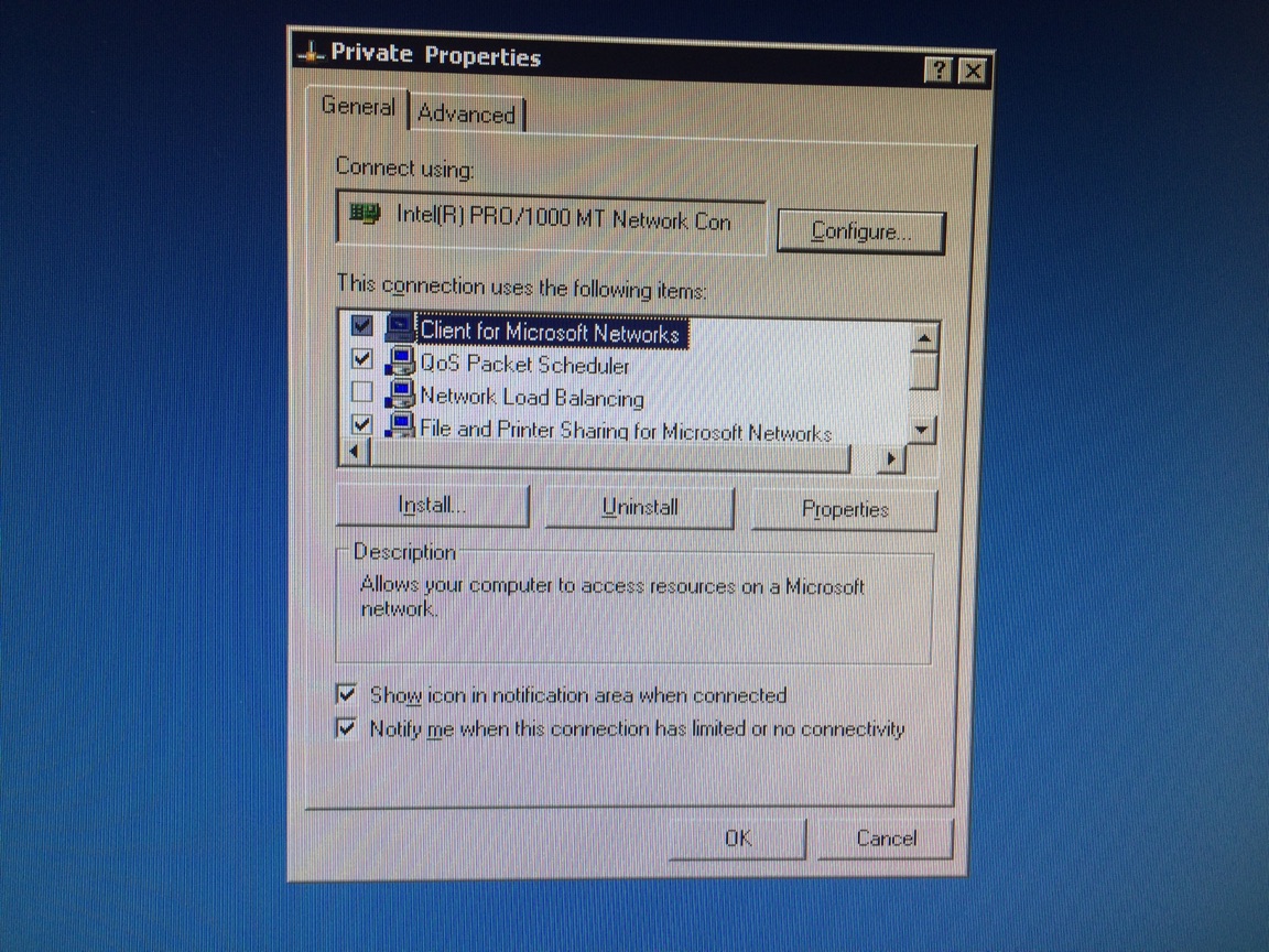

For the record, or just a "heads up": some may recommend you "tinker" with the NIC such as uninstall, update drivers, reset TCP/IP stack.  SBS is VERY fussy about that and I have seen it result in a server rebuild, or restore from backup.  The IP is integrated in DNS, Exchange, SharePoint, and much more.  You must run the wizards if changes are made to networking.

masnrock
Disabling isn't the same as uninstalling. Could be a problem of software components. Are you able to remove the client from the server, and not the console? (that would be ideal to avoid breaking the clients)

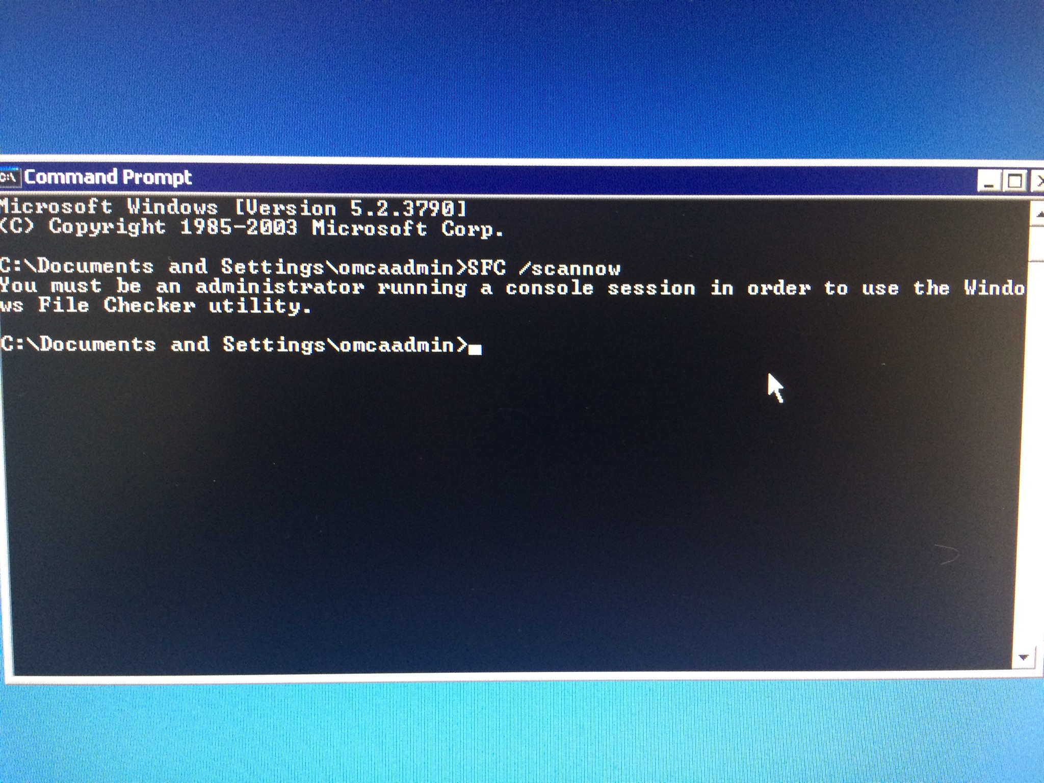

Can I run the troubleshooting tools mention  SFC /scannow and DCDiag using RDP?

Avatar of Rob Williams
Rob Williams
Flag of Canada image
In theory, but you have to connect to the server with the console session to run SFC now, and it will probably ask for the install CD. To use console session:
mstsc  -v:servername  /admin
DCDiag shouldn't be a problem.
Must say I have never run SFC on SBS.  I would be afraid it will replace current system files with the CD files which may be much older than current SP and patch files.  Doing so might require re-installing all service packs.  The order on SBS 2003 is very important, thus it could open a whole can of worms.
You should be able to run SFC and look at the recommendations, if any, then cancel.  I think you have been warned, SBS 2003 is unsupported and you could easily be in a failed server position when making changes.  Sounds like you have a tested backup though, so that takes a lot of the pressure off.  The difference with your 1985 Toyota is a company is not depending on it  :-)

Avatar of pgm554
pgm554
You need to run sfc /scannow as an administrator ,so open a command prompt ,right click and run as admin.

I also noticed slow Authentication to DC when user turn on their computer in at the beginning of the work day. About 5 minutes.
Rob Williams
That is usually a DNS issue.  It happens when the client's NIC configuration has both the server and an ISP or router as an alternate.  The server MUST point only to itself, and the clients point only to the server, for DNS.  The ISP gets added as a forwarder in the server's DNS console.

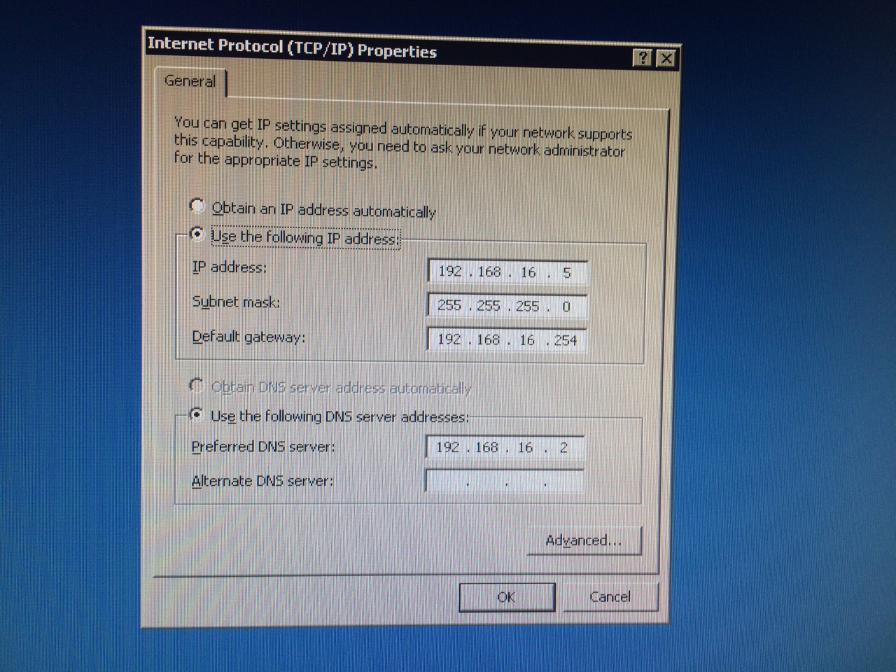

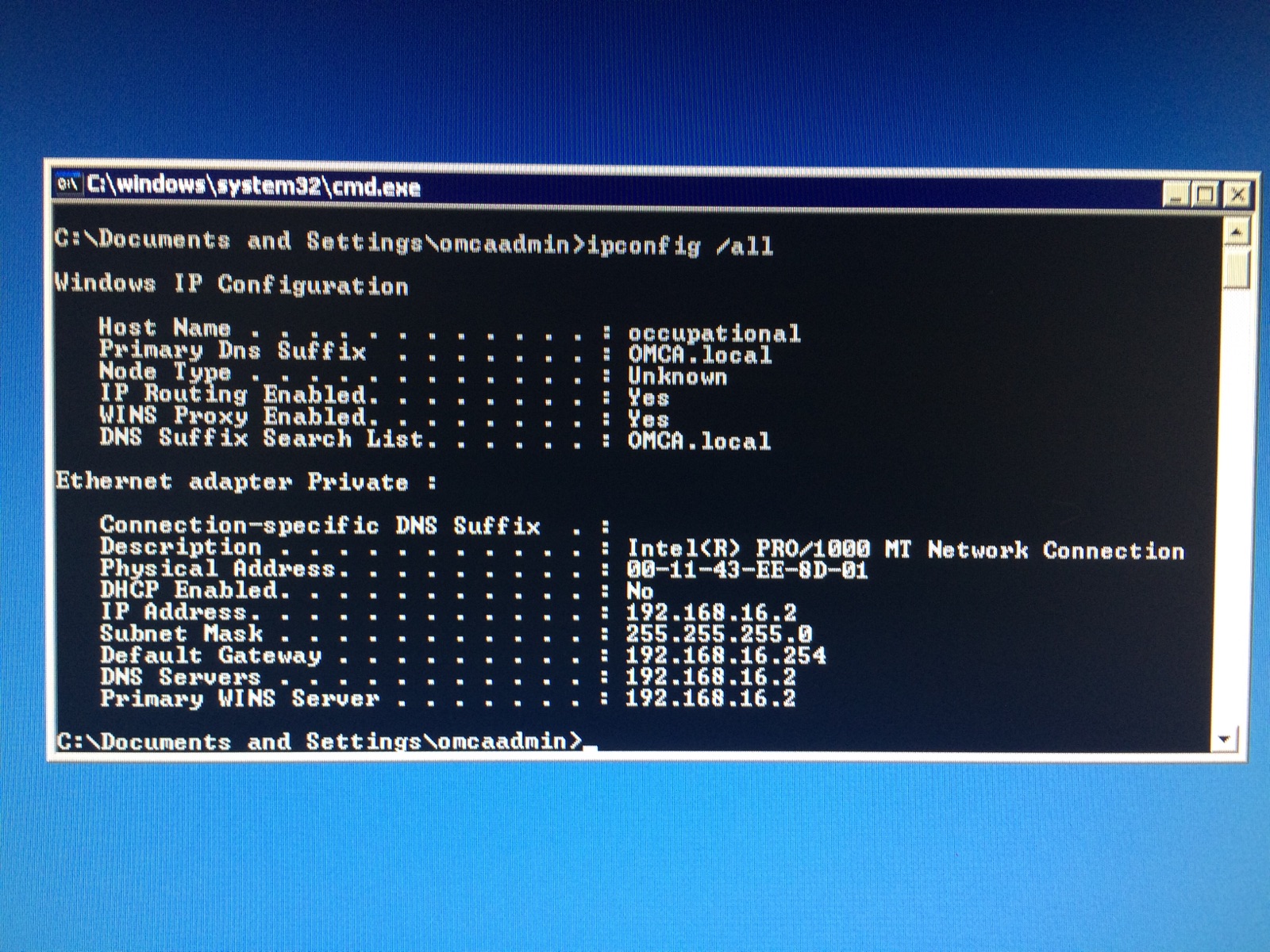

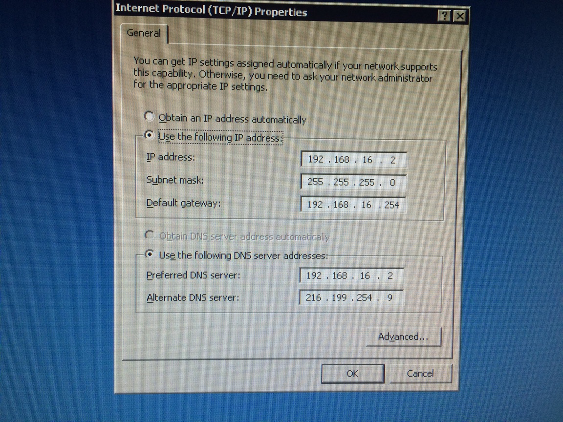

Avatar of Wizkid003
Wizkid003
Every device in this environment has static IP addresses. See attachment
Avatar of masnrock
masnrock
Get rid of that second DNS server on the DC.
Rob Williams
The OMCATRM is fine but having 216.199.254.9 as an alternate on DC is a serious problem.  It should be deleted and run  ipconfig  /flushDNS

Regardless get rid of it.  #1 DNS mistake.
Rob Williams
>>"216.199.254.9 is my ISP Windstream."
As mentioned, that is a problem !!!!!!  When you try to resolve an internal name it often contacts the alternate first, or it responds firs.  If it does, it cannot resolve the internal DNS name.  When this happens you get delays tll it times out, or sometimes fails all together.
Add the ISP as a forwarder in the DNS management console.

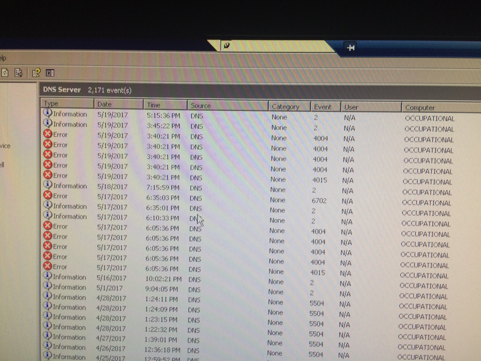

Avatar of Wizkid003
Wizkid003
I am locally at the server now. I remove 216.199.254.9 from nic, did ipconfig /flushdns, ran internet wizard and reboot the server, but that did not fix the problem.
Avatar of Wizkid003
Wizkid003
ran the sfc /scannow, but don't have sbs 2003 CD

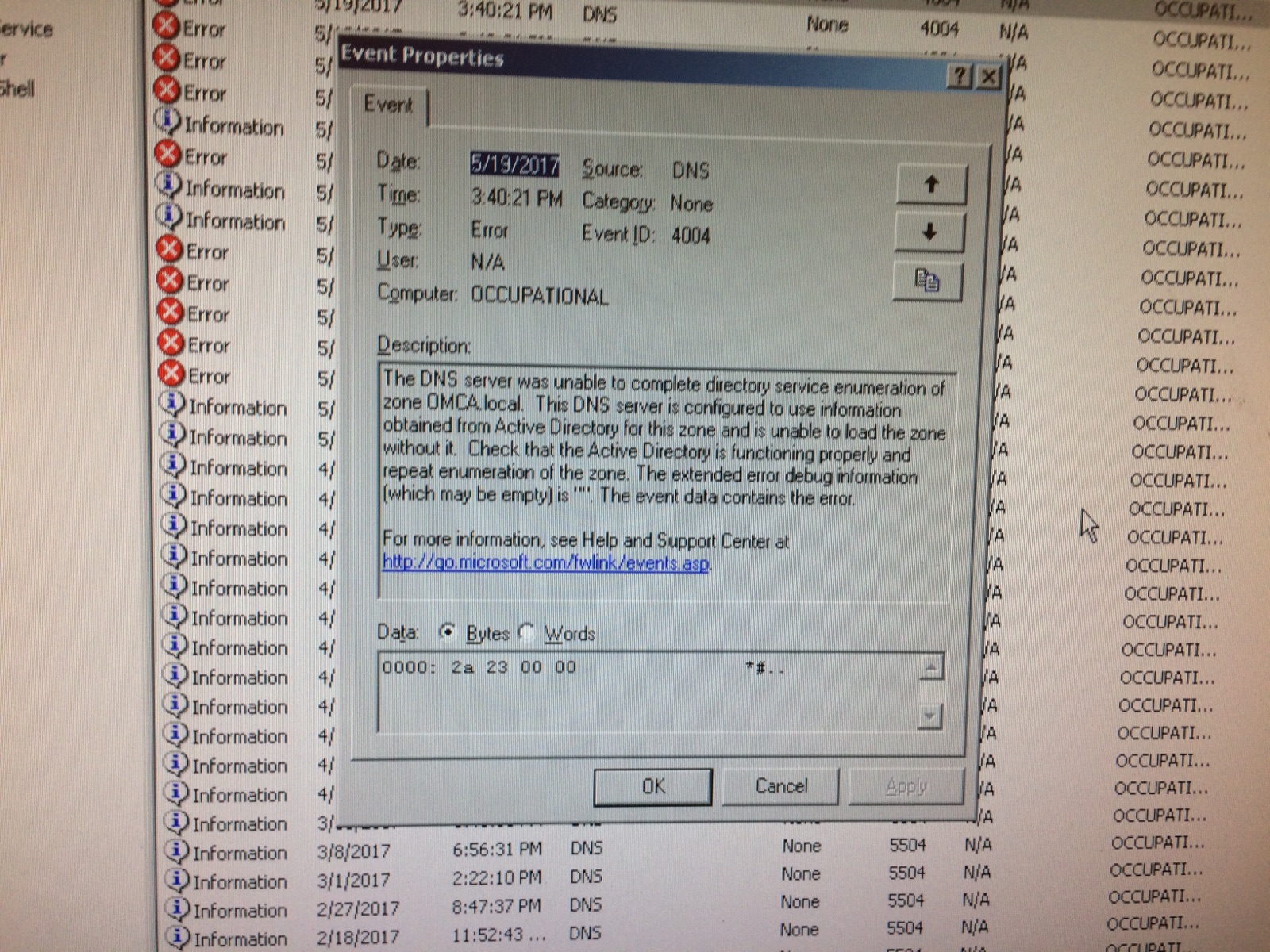

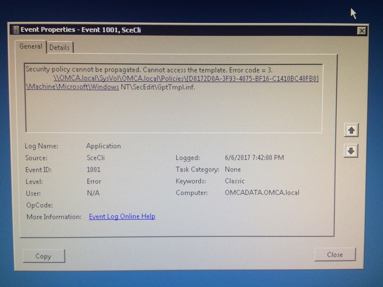

Avatar of Wizkid003
Wizkid003

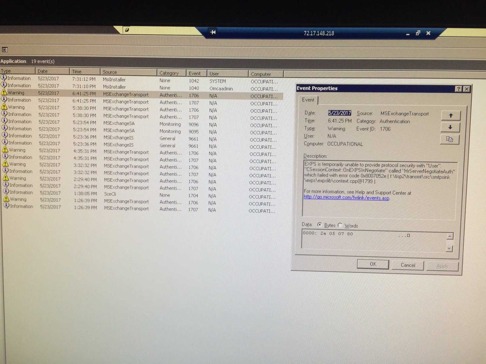

After removing 216.199.254.9 from secondary DNS, I got the attach message from Eventvwr DNS server

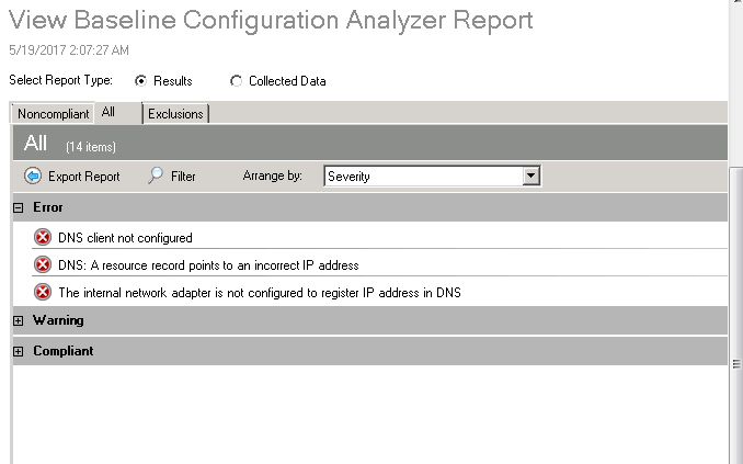

Avatar of Wizkid003
Wizkid003
Attach is the sbs analyzer report
SBSBPA.SBS-2003-Scan.201705191702491.xml
Rob Williams
Sorry I am out of the office and slow responding.  You asked; "Rob please list the steps in order that I need to follow and can I apply those steps via RDP?"
Which steps?  Removing the DNS server, which it sounds like you did.
There is no way those DNS errors relating to active directory are from removing 216.199.254.9.  You could get those errors if you removed 192.168.16.2

From the bpa it does call out two network adapters being present.
<Value>192.168.16.2</Value>
                                                                                    <Rule Name="2IPs" Title="Multiple IP addresses assigned to the internal network adapter" Error="Warning" Query="count(($_/../Value | $_/../Instance)) &gt;1" Text="The internal network adapter of this server has two or more IP addresses assigned to it. You should remove all but one IP address." AlwaysEvaluate="True" Pass="False" />

I trust you ran the BPA before removing the 216.x.x.x address?  The BPA resultstates, as I have warned; "The DNS client is not configured to point only to the internal IP address of the server"
It also says it is running as a virtual server.  You may have issues with a virtual switch.
It shows 11 "networks" which means there have been 11 NICs or 11 reconfigurations, you may have a ghost NIC.
As pgm554 suggested, run the Connect to the Internet wizard which may fix these issues.  also as he said, best to run from the console.
It states disk space is very low.  If low enough some services may not start.
It is difficult to go through it all in XML format, you are best to look at the BPA results in the console and it will tell you the key issues and recommendations to fix.

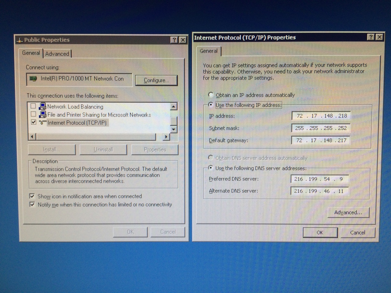

Rob Attach is the info you requested. I do have 2 adapters, but the other one is disable. I am only using 1 adapter which connect directly to my sonicwall.
Rob Williams
Is it actually disabled or disconnected?  Ipconfig implies disabled, which is what it should be.

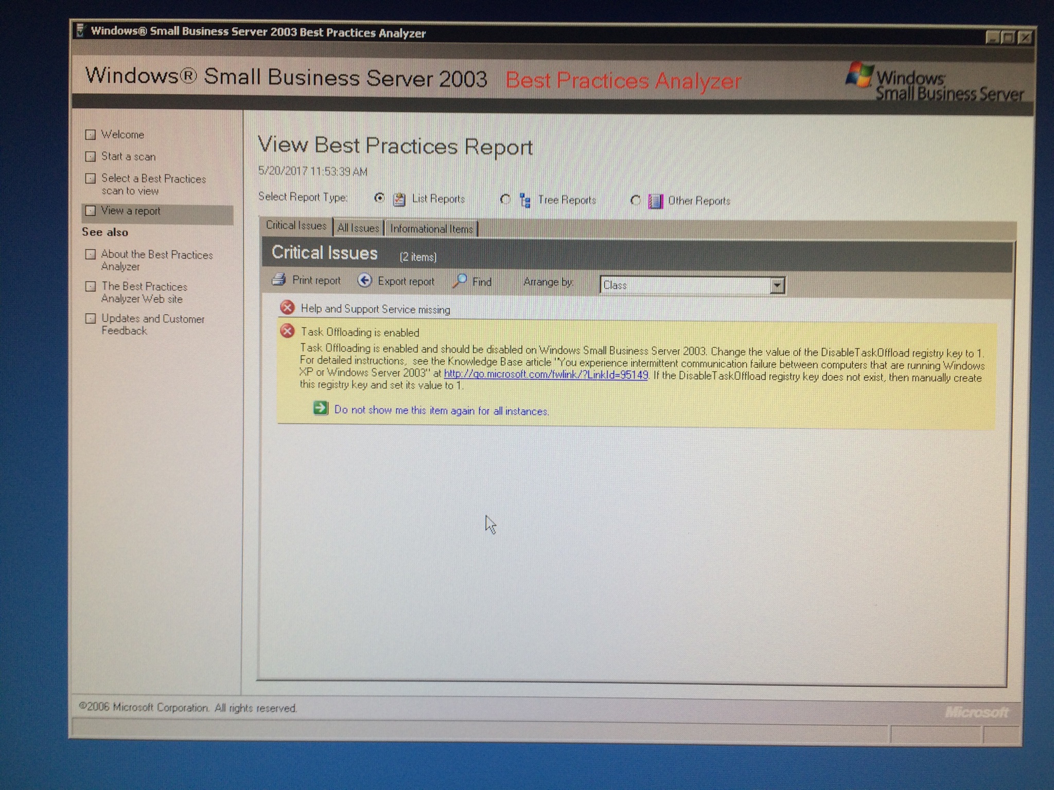

1 - Rob I ran the BPA after removing the 216.
2 - I do not have any virtual server. I only have 3 physical servers.
3 - See attach file for Server Management, is that the console you are talking about?
4 - I have 35GB free space.
5 - How do I look at the BPA report in the console?
Avatar of Wizkid003
Wizkid003
disable and disconnected. There is no Ethernet cable connected to that adapter.

after you run the BPA there is an option to view report

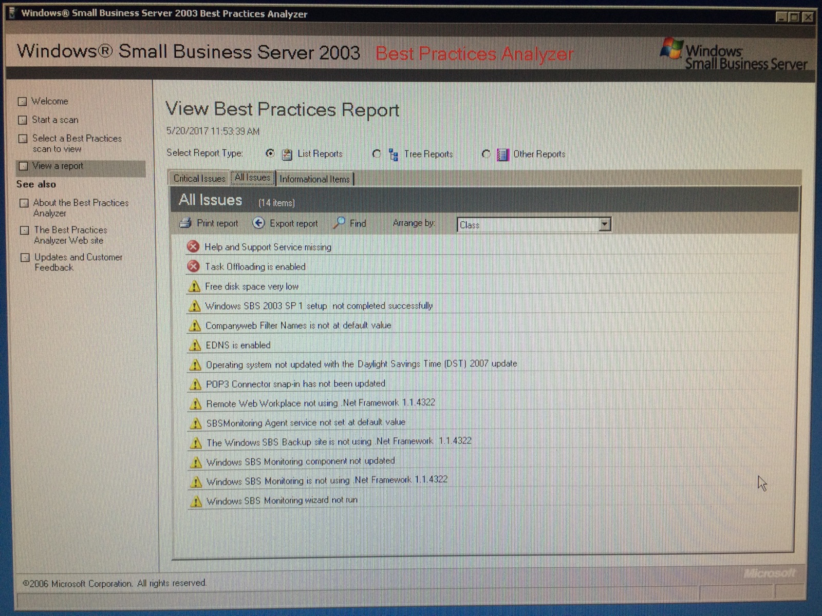

Avatar of Wizkid003
Wizkid003
pga554 all I have to do is copy and paste and just rename to bpa.png?
Avatar of pgm554
pgm554
you can name it anything you want.
Avatar of Wizkid003
Wizkid003
Attach is the BPA result from console. Let me know if I need to make any changes to registry.

Wizkid003
BPA all issues attached. The reason I cannot send you the file in .png format is because I am remote into the server and cannot email you from that server. If you still need .png format, I can email to you on Monday, but if you need for me to check a particular item, then just let me know and I can make the change from my desktop.

It mentions daylight saving time, does the server time and all connected devices match?  If off by more than 5 minutes you will have authentication issues and more.
TAsk offloading is more of a performance issue than a connection issue

Was the BPA-all-issues.jpg good enough or do you need a more detail report. I am not sure how to save it in another format. Please advice. I am going to the office now.
Avatar of Wizkid003
Wizkid003
Only on the DNS Server. See attach file.
Avatar of pgm554
pgm554
Hmmm...Event ID:      2004
Task Category: Resource Exhaustion Diagnosis Events
Sounds like you got a memory leak.

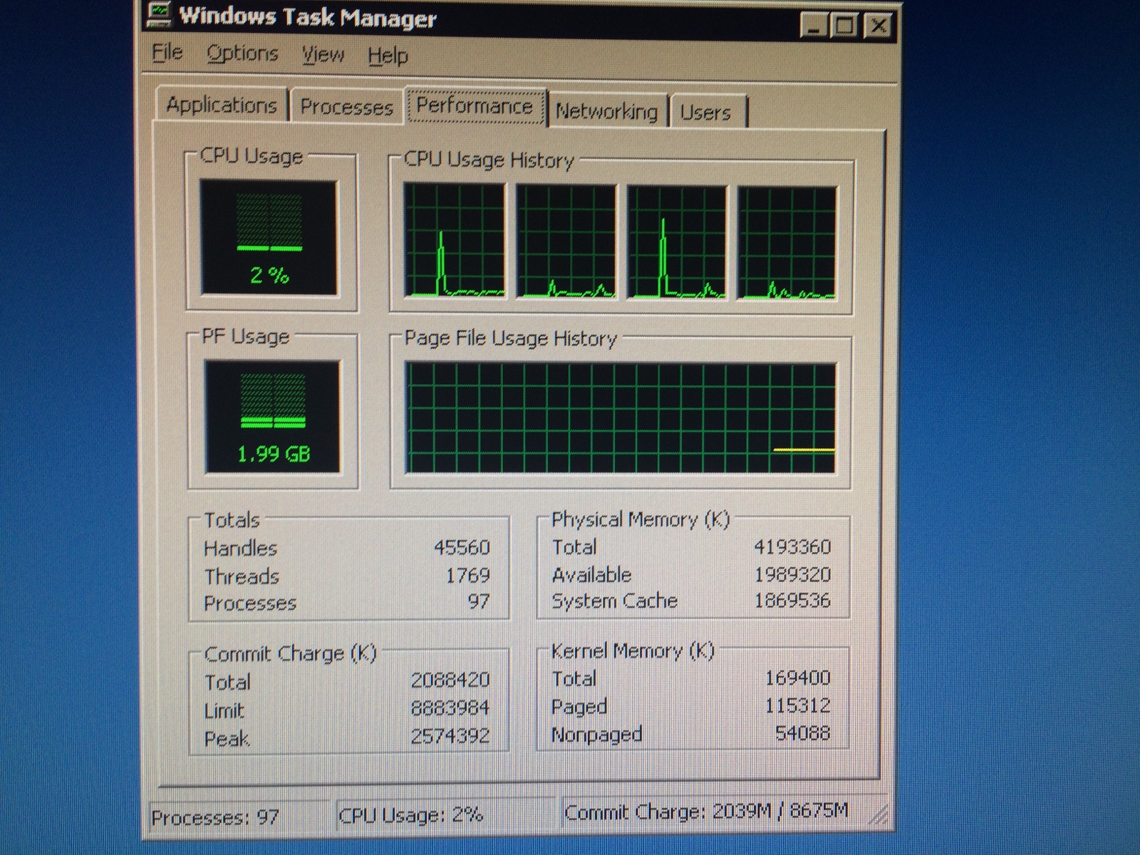

In task manger under the performance tab can you upload a screen shot of the current memory and CPU stats?

1 - File Attached

Could you please post screen shots of the Local Area Connections properties? Want to see the clients and protocols that are present.
Avatar of Wizkid003
Wizkid003

Let's analyze sections of your issues...
1) How is your hard drive partitioned? Is OS in a separate partition from everything else? If so, how much space is left where the OS is?
2) Have you tried correcting the .Net issues?
3) Have you tried disabling Task Offload?
Avatar of Wizkid003
Wizkid003
1 - Raid1 - OS - Free space = 36GB, Raid5 - Data files - free space 36GB
2 - No did not tried correcting the .Net issues, don't know where to start

I'd start with disabling task offload. Check out properties for your NIC cards (will most likely be in the Advanced tab)
Avatar of Wizkid003
Wizkid003
Like I said before I did a full image restore from previous backup and the system was working fine about 24 hours, then the problem occur again. I would like to do another restore, but I need recommendation to have some type of sniffing tool in place to capture the error next time around. Any recommendations will help.

Avatar of Wizkid003
Wizkid003
Attach is what I get when I go to advance tab

That error just indicates RRAS is enabled

Was the BPA report I ran not good enough. If not please tell me what I'm doing wrong so I can rerun and send to you.

Most of your critical errors point to Active Directory, which is most often caused by DNS but from what we have seen, after your changes, it is OK.  Have a look in the event viewer under "Applications and Service Logs", in the "Directory Services" and "DNS server" logs for any red Errors since the rebuild.

No ,at one point it had :
Event ID:      2004
Rob Williams
Was it 2004 or 4004?  I couldn't find former.
Avatar of Wizkid003
Wizkid003
4004, but they say that's normal when you reboot the server.

Was anything like Client for Microsoft Networks unchecked when you looked at the properties for your network connection?
Avatar of Wizkid003
Wizkid003
network properties  are all ok.

I disjoin and rejoin an xp workstation from the domain and receive the following attached.

If you cannot access any services on the DC you won't be able to join the domain, though that sounds like a DNS issue.  Does the PC point ONLY to the server for DNS?  You cannot have an ISP or router, even as an alternate/second.

I've decided to think outside the box and check he Application Event ID: on one of my win 7 workstation and my win server 2008. Attach is the file, could this be my problem?
Avatar of Lee W, MVP
Lee W, MVP
First, please read my post on effective screenshots:
https://www.experts-exchange.com/articles/29715/Effective-Screen-Shots.html
(I'm specifically referring to embedding).
Second, you need to review the issues found with DCDIAG /C /E /V and REPADMIN /SHOWREPL
