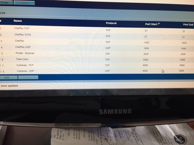

We had some security cameras installed and the installer asked me to open port 8000 for the dvr.  We have a Sonicwall 1260 Pro and I followed the instructions for port forwarding.  I created the service for both TCP/UDP, port 8000 and then created the group.  I used the public server wizard to allow public access to the camera ip.  After everything was complete I used the site, http://www.yougetsignal.com/, to check if port 8000 was open.  Unfortunately, the port is still closed.  I'm stuck figuring what I could be doing wrong.  We do have 2 static ips for the site.  The other ip is used for the fax machine line.  i don't know if this could cause the problem.  Any help is appreciated.

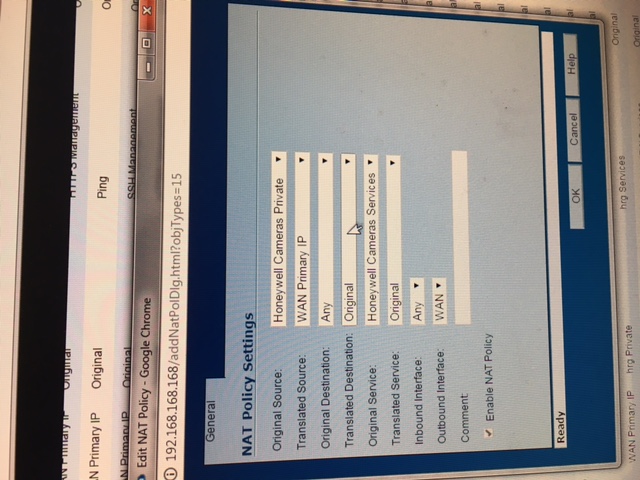

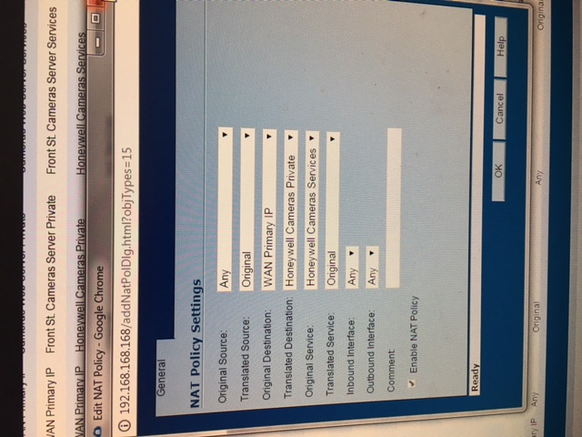

I assume you ran that test at home. Could you please show the WAN interface settings on your Sonicwall, along with NAT policies and access rules?

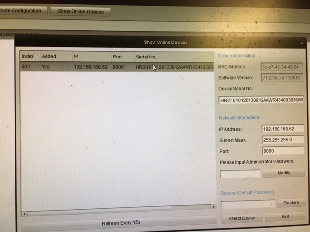

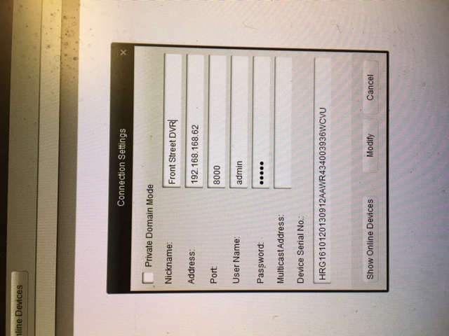

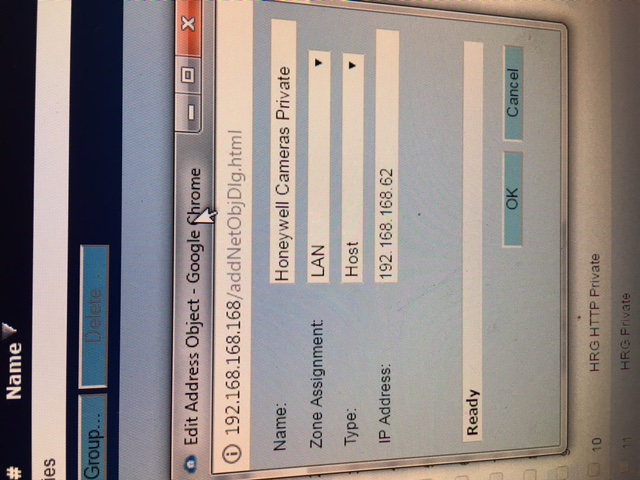

@masnrock yes I meant the dvr IP.  Model: Honeywell HRG161.  I asked the installer if 8000 was the correct port and his response was "8000 on internal, external can be whatever you want"  I tried 192.168.168.62:8000 from inside the network this morning but a page did not open.  Howver, the camera web interface works onsite.  I attached some screen shots of the settings. I will tke pictures of the WAN interface settings, along with NAT policies and access rules and upload.

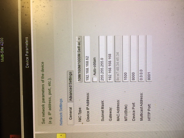

The second picture says you should use http://192.168.168.62:8001 for the http access; but, it also shows 192.168.168.168 as the gateway.  Is that the ip address of the sonicwall?
Avatar of masnrockmasnrock🇺🇸
So the answer depends on what you want to forward, which I assume is the HTTP port. And Davis is right based on your screenshots: you should be forwarding 8001, not 8000.

I called our ISP and asked about closed ports.  They informed me that they don't close ports.  They also said that having 2 static IPs shouldn't cause a problem.  I'm pretty lost here.  We have the same router at a different location and forwarding ports for security cameras was never a problem.  I attached snapshots of the NAT Policy Settings, Address Object Settings, and the Services settings for port 8000.

What about the other NAT rule? The one coming from the outside and going to your DVR

The tech installed the honeywell software on a workstation and we are able to view the cameras.
