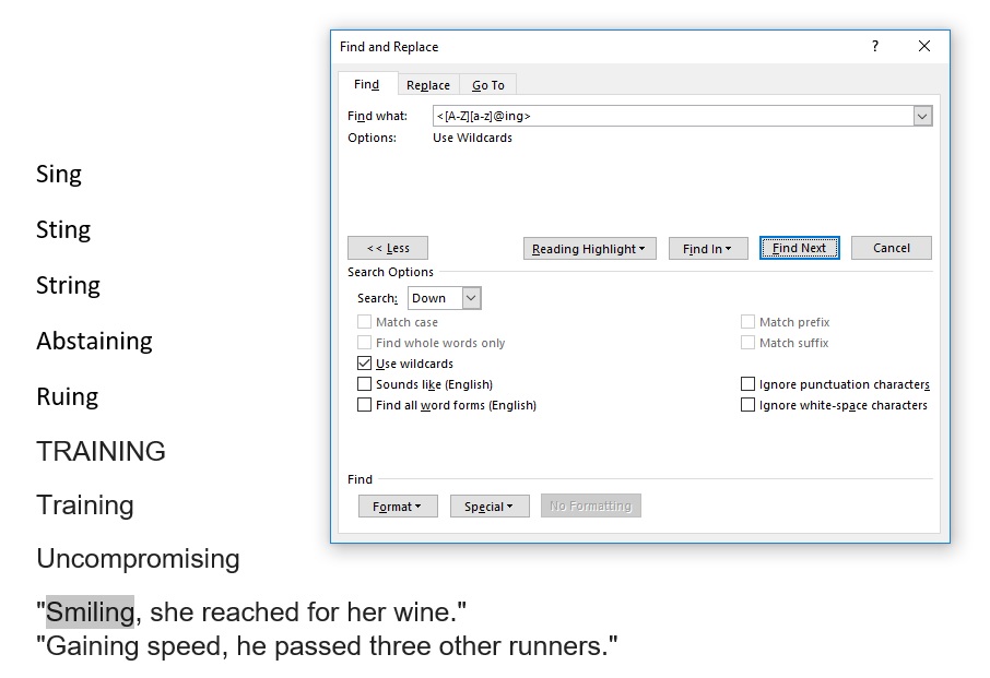

Stephen, sorry I misread your comment. It will work in either find method. Did you remove the '1:' from the command? That is added by the forum software when you list a line of code.
For instance
Line 1
Line 2
But when wrapped in code tags becomes
Line 1
Line 2
I have attached a screenshot of the Advanced find working.

Please look at this screenshot and attached docx. Still not working for me. (Word 2016.)
Find ING not found
No rush on responding, as I'm getting ready to head out to dinner.
PS- Daryl, did you mean two commands would be needed if I need to handle words like "Ruing"? If so, no big deal, such verbs are few and far between, at least in my novel. :)
Thanks, everyone!
IngTest.docx
Daryl Bamforth
You need to tick use wildcards.
No 1 for 4 letter words (Ring, Sing) 1 for more than 4 letter words (Ruing, Bring).

What word were you expecting it to highlight?
The pattern it is looking for is as specified right at the top..
The pattern here would be.
<Capital letter><one or more characters><"ing">
None of your 'ing' words in that section of text start with a capital letter. If you changed 'tearing' to 'Tearing' you will find it now matches.
Also,
<[A-Z][a-z]@ing>
only works on words that are 5 or more characters. For words of 4 characters (such as 'Ring') you would just remove the '[a-z]@' section as that becomes irrelevant.
<[A-Z]ing>
If you want to get lower case words (such as the 'ring' bits of your supplied text) then you need change the [A-Z] to [a-z] .. OR to match on upper or lower case as first letter you could change it to [A-Z,a-z], so
<[A-Z,a-z]@ing>
Ultimately you need to decide what it is you need to search for, as the search string was very specific to ensure it didn't get words that didn't match the original pattern.

OMG, my bad. Of course!  I forgot the premise of my original question.
As I said this morning:
>> I must be missing something obvious b/c I didn't have my orange juice with breakfast... ;)
Will close this question out within a day. Thanks Daryl and John and sorry to have wasted your time....
