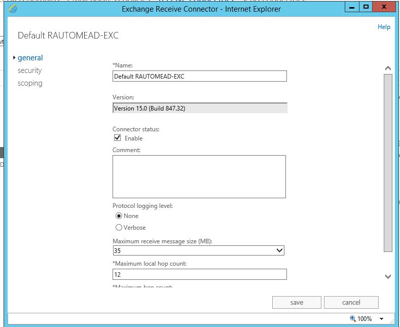

MAS please see below for the receive connectors on the new Exchange 2013 server
Which connector are you talking about as both the hub transport one called Default RAUTOMEAD-EXC and the frontend one called Default Frontend RAUTOMEAD-EXC do have server authentication enabled and have been restarted. I've also restated the transport role on the old 2007 but that did not help either.
Those are the current settings on the hub transport one. I've also checked that both servers are using the same SSL certificate and it is fully enabled for IIS and SMTP on both servers.
