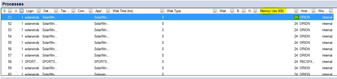

If you suspect that the reports are causing issues you could also check "Recent Expensive Queries" and scroll down to see if any of them are extremely high.

Let's start with with Processes. If you look at Memory Use (see photo) and then scroll down look for something that is in the thousands or more. We are trying to isolate the process that is causing your server to be slow assuming you are only using this server for SQL.

I looked at memory and even doubled it to 32GB just to test and it made no difference.
