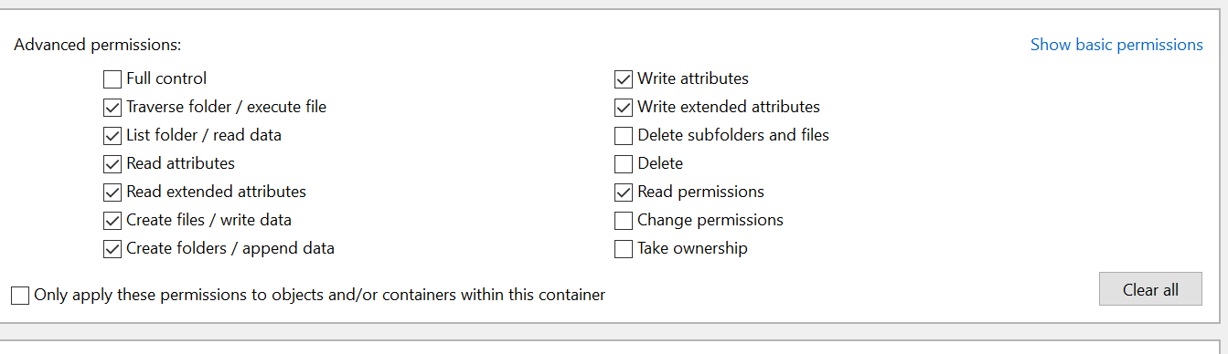

As shown in image , how could i stop? the modify operation let user delete, if i turn that off then the error is displayed.

Right-click folder, Properties, Security.
Unmark Editing (and Full Control).
/gustav

done, and now also i can delete files,any idea?

Avatar of WS
WS
Flag of United Arab Emirates image
yes here exactly the point is. when i turn this delete off, automatically Modify also get off and then i start getting error above. If i turn this delete on ,modify also get turn on and all the things get start working but here is the deal this allow the user to delete also the file which is not required at all.

Oh. Problem is, that if you can modify a file, you effectively delete it by overwriting it with a zero byte file.
But try flipping the top combobox to Deny  , remove all marks, and set Delete.
