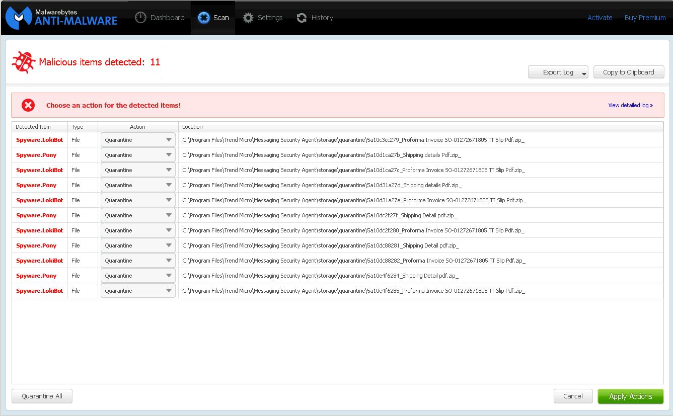

also im running malware bytes now

Avatar of Fernando Marambio
Hi Mas
I have ran malwarebytes and it only picked up the quarantine folder from Trend Micro
I also ran an open relay test and that came back good
I have attached screen shots
Avatar of Arif Khan
Arif Khan
Avatar of Arif Khan
Arif Khan
Well I saw, you exchange is infected with viruses you need to remove this one first.
