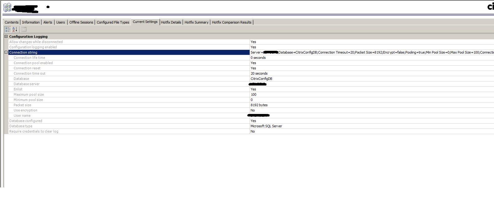

So what's happening is if you take a look at the screenshot i need to change the username.  the current username is the old system admin, who no longer works here, in the last post they mentioned disabling this account would have no effect. However after disabling his account, Citrix Delivery Console is not able to discover anything, cant see the farm until we re enable his account.

Carl, is there anyway to check who the current username/password is set as?  Before running this i would like to verify.  I had a similar issue in the past, I ran this command on the servers the issue went away.

Carl Webster
Username yes, password no.
The SQL server, database, and username are in the mf20.dsn file.
The dsmaint command is the only supported way to change the username and password.
ManieyaK_
Carl, I've checked the credentials for mf20.dsn it shows the service account i created a while ago SQL_Service.  Not sure where the user is attempting to log into.  Or how to modify the connection string in the above screen capture.

Carl so I've figured the issue with the connection string.  Now I'm having issues with running discovery process, we have one server 2008 R2 hosting the application, one server 2008 R2 for application I can run discovery on the local machine, if I'm on server 1 i can only run discovery for server 1 not server 1 & 2.  If I'm server 2 i cannot see server 1 discovery fails.
