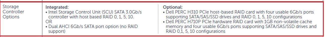

it seems that you can have either SATA 0 and SATA 1 or HDD 0 - HDD 3 ports only in a software RAID mode without a RAID card.
These are your options:
Please read this Article:
http://www.bbt.si/modules/uploader/uploads/s_product/file/57f3e3148e4eb_dell-precision-t5600_copy1.pdf

You have to try all possible combinations of Ports and modes,  because you can hardly find any information related to Attaching SSD and HDD with two optical drives at the same time to that Motherboard.
