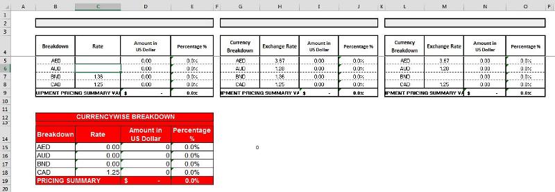

I'm trying to write a simple formula to check whether either 1 or 2 table are blank and, if so, leave the resulting to display the value of non-blank table.
I want the resulting table to only display a value if all or either 1 table are filled in.
These are formula I tried.
=IFERROR(C5,OR(H5,AND(M5))) if c blank then shows blank
=IFERROR(C6,AND(H6,OR(M6))) if c blank then shows blank
=IFERROR(M7,OR(H7,OR(C7))) if m blank then shows blank
=IFERROR((C5,H5,M5),IFERROR((H5,M5),IFERROR((C5,M5),(C5))))
Plz help..

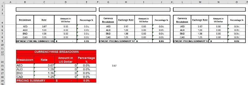

HI Rob, thx for help it [code] =IF(C5<>"",C5,IF(H5<>"",H5,IF(M5="","",M5))) [/code] worked..
Hi Shums, thx for your help too its worked as well..
