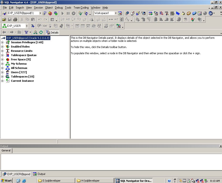

There is something that says SQL Navigator and I will attach screenshots as it shows the small tables I need into CSV or Excel like we said.  Just a more readable format for a developer.    (ATTACHED)

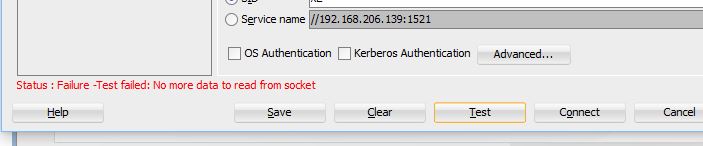

I've corrected the SID name and just using XE:
Now I get the error message below:
SQL Developer from My Machine to the VM with DB says:  Test failed: No more data to read from socket  ( I feel so close.)
The status for listener is also below, but I know using the right one and right details now it looks like.

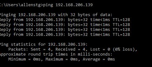

I can ping, attached.
Two error with Firewall on Windows 2k3
On Firewall I have the Oracle TCP Port added as exception
Firewall ON - Status : Failure -Test failed: IO Error: The Network Adapter could not establish the connection
Firewall Off - no data socket (Attached)
