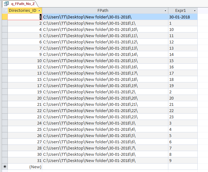

results now in
And now for the question: What do you expect from this function to return for each row? Cause your requirements (posts) are not really clear about that.

I need to return all of the numbers at the end of the pathway....but no date as in the first record...I forgot that gets added in as a title holder...I need to strip it out of the query results, sorry....
So i need the numbers 1 to 23 inclusive...
