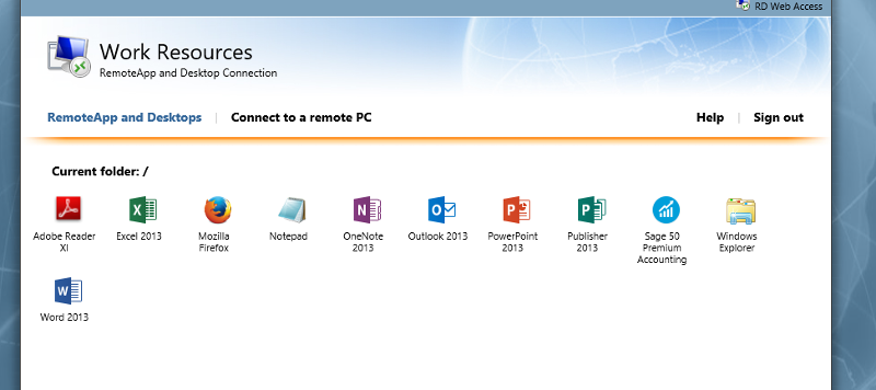

Hello,
I have been in and out of forums checking on most queries for this, but in my particular instance, not many have solved this issue that I suspect might have something to do with the FQDN relationship between certificate and host server being .local vs .com.
When I browse externally to URL https://remote.server.com I can log in (with either a standard user or admin) and I am presented with 'RemoteApps', however, when I log in on the local server (as admin or standard user) I am presented with 'RemoteApps' along with 'Connect to a Remote PC'; which is exactly what I want to see when I log in externally from any client.

Hello and thanks for your response.
I am temporarily using 3389 (currently for doing direct-to-server admin outside of RDweb) - I will change this when I pass the point of understand what is going on here.
So, when you mentioned "Add the RDWeb URL to Trusted Sites."
Are you referring to the internal address of my RDweb or the FQDN ?
And are you advising to add this on the server or the client trying to reach that address?
But in response to your question, I get to see a similar image you displayed only when I am logging in to remote.server.com on the stand alone server locally, when I jump on another client PC in the LAN and browse to remote.server.com (using IE).. "connect to a remote PC" is omitted from view.
Regards

Well I should state, that "Connect to a Remote PC" was appearing locally prior to following your steps. Â IT is the external clients not seeing "Connect to a Remote PC" that is the concern.
I will try your advise on the external client 'IE Trusted-Sites' and post the results shortly. Â Thanks for the quick response.
To confirm, I tried IE on another computer.. it added some ActiveX plugins and then I was able to get in!
Thanks very much, it would appear the IE security settings was preventing me from getting to the gold.
Now, Â I have a new issue, adding the workstations that are available for remote access to GP ! :)
Cheers Philip!
Cheers Philip!
