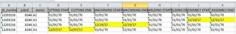

Hello,
I have a query that pulls dates for different work cells.  Here's the code:
SELECT dbo_projects.job_number, dbo_projects.jobid, dbo_projects_schedule.series, Format(DateAdd("s",[act_start_cut],#1/1/1970#),"mm/dd/yy") AS [CUTTING START], Format(DateAdd("s",[act_end_cut],#1/1/1970#),"mm/dd/yy") AS [CUTTING END], Format(DateAdd("s",[act_start_mach],#1/1/1970#),"mm/dd/yy") AS [MACHINING START], Format(DateAdd("s",[act_end_mach],#1/1/1970#),"mm/dd/yy") AS [MACHINING END], Format(DateAdd("s",[act_start_weld],#1/1/1970#),"mm/dd/yy") AS [WELDING START], Format(DateAdd("s",[act_end_weld],#1/1/1970#),"mm/dd/yy") AS [WELDING END], Format(DateAdd("s",[act_start_prep],#1/1/1970#),"mm/dd/yy") AS [FAB PREP START], Format(DateAdd("s",[act_end_prep],#1/1/1970#),"mm/dd/yy") AS [FAB PREP END], Format(DateAdd("s",[act_start_coat],#1/1/1970#),"mm/dd/yy") AS [COATING START], Format(DateAdd("s",[act_end_coat],#1/1/1970#),"mm/dd/yy") AS [COATING END], Format(DateAdd("s",[act_start_assy],#1/1/1970#),"mm/dd/yy") AS [ASSEMBLY START], Format(DateAdd("s",[act_end_assy],#1/1/1970#),"mm/dd/yy") AS [ASSEMBLY END]
FROM dbo_projects LEFT JOIN dbo_projects_schedule ON dbo_projects.jobid = dbo_projects_schedule.jobid
GROUP BY dbo_projects.job_number, dbo_projects.jobid, dbo_projects_schedule.series, Format(DateAdd("s",[act_start_cut],#1/1/1970#),"mm/dd/yy"), Format(DateAdd("s",[act_end_cut],#1/1/1970#),"mm/dd/yy"), Format(DateAdd("s",[act_start_mach],#1/1/1970#),"mm/dd/yy"), Format(DateAdd("s",[act_end_mach],#1/1/1970#),"mm/dd/yy"), Format(DateAdd("s",[act_start_weld],#1/1/1970#),"mm/dd/yy"), Format(DateAdd("s",[act_end_weld],#1/1/1970#),"mm/dd/yy"), Format(DateAdd("s",[act_start_prep],#1/1/1970#),"mm/dd/yy"), Format(DateAdd("s",[act_end_prep],#1/1/1970#),"mm/dd/yy"), Format(DateAdd("s",[act_start_coat],#1/1/1970#),"mm/dd/yy"), Format(DateAdd("s",[act_end_coat],#1/1/1970#),"mm/dd/yy"), Format(DateAdd("s",[act_start_assy],#1/1/1970#),"mm/dd/yy"), Format(DateAdd("s",[act_end_assy],#1/1/1970#),"mm/dd/yy")
HAVING (((dbo_projects.job_number)="12203216") AND ((dbo_projects_schedule.series)="A2"));
and here's the result:
result 1
Notice the highlighted fields.  I want group it somehow to get one record like this:
result 2
Thanks for your help,
Joel

I don't know what the dateadd()s and format()s are all about but your table is not normalized.  If each of the dates were on a separate row, you would use a cross tab to pivot them.
Staying with your current format, assuming that only one row in a set would have any given date column filled in, you could use Max() for each date column
SELECT dbo_projects.job_number, dbo_projects.jobid, dbo_projects_schedule.series, Max([act_start_cut]) AS [CUTTING START], Max([act_end_cut]) as [CUTTING END], ... rest of the dates
Group by dbo_projects.job_number, dbo_projects.jobid, dbo_projects_schedule.series
Order by dbo_projects.job_number, dbo_projects.jobid, dbo_projects_schedule.series;
Gustav Brock
Remove all instances of Format in your SQL, or the "dates" will be text which you can't do any meaningful "Max" on.
Then you can do something like:
IIf(Max([ASSEMBLY START]) = #1/1/1970#, Null, Max([ASSEMBLY START])) As [ASSEMBLY START]
and apply a format like this in the form:
mm/dd/yyyy,,,"N/A"
Genius123
Thank you.  The Max worked.
