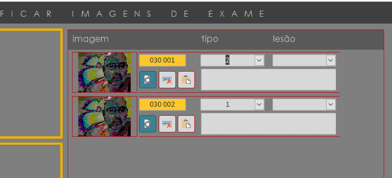

On my app I have a form/subform group and they are (almost) correct. The situation is that I need to show a different image on each of the subform records and they are always showing the same (and initial) image.
Please check below the screenshot
The keys to the records are OK and I am using the "ON CURRENT" event to modify the source images according to the key.
I did put a break point (and debug.print) on the code to change the image and, surprisingly it is always showing the initial record (30001). So it looks that I should not be using the "ON CURRENT".

Well... but could not the problem be in my code? After all is always selecting ONLY THE FIRST RECORD....
Gustav BrockCIOCommented:
It looks like you retrieve a picture at the OnCurrent event.
But if the picture control is unbound, all records will show the same picture.
The picture control has to be bound for each record to show individual pictures.

Well...
Thinks are improving.. but not much
For the moment, I totally forgot the OLE approach and came back to the old file download approach. Now what happens is the following:
1. On LOAD
Shows ALL images equal
2. after selecting  the second record so it fires the "ON CURRENT"
I am using ONLY the  standard image control and my complete code for the ON CURRENT is:
Private Sub Form_Current()
    Dim strFileName As String
    Dim LifeLingerDB As DAO.Database
    Dim q01_pacienteSet As DAO.Recordset
    Dim q01_pacienteDef As QueryDef
    Dim q02_exameSet As DAO.Recordset
    Dim q02_exameDef As QueryDef
    Dim q03_imagemSet As DAO.Recordset
    Dim q03_imagemDef As QueryDef
    Dim q03A_imagemSet As DAO.Recordset
    Dim q03A_imagemDef As QueryDef
    Dim strSetSQL As String
    Dim bUpdate As Boolean
    Dim Twat As Date
    Dim nFileNum As Integer
    Dim byteData() As Byte
    Dim varStatus As Boolean
    Dim imgSnapShot As Variant
    Dim varImg As Variant
'On Error GoTo errorTrap
    Call logMe("Form_Current - frmImagemNovaThumbNail", "start")
    strFileName = "c:\lifelingerIIimg\[" _
             & Format(Me.frm_IDpaciente, "000000") _
             & "." _
             & Format(Me.frm_idExame, "000000") & _
             "." _
             & Format(Me.frm_idImagem, "000000") _
             & "].jpg"
            Me![frm_imgScreenShot].Picture = strFileName
    Call logMe("Form_Current - frmImagemNovaThumbNail", "end")
    Exit Sub
errorTrap:
    MsgBox "[Form_Current - frmImagemNovaThumbNail]." & "[" & Err.Number & "].[" & Err.Description & "]"
    Call logMe("Form_Current - frmImagemNovaThumbNail", "errorTrap:" & "[Form_Current - frmImagemNovaThumbNail]." & "[" & Err.Number & "].[" & Err.Description & "]")
    Resume Next
End Sub
so I am really wrongdoing something as it does not change just th current image but ALL the images....
