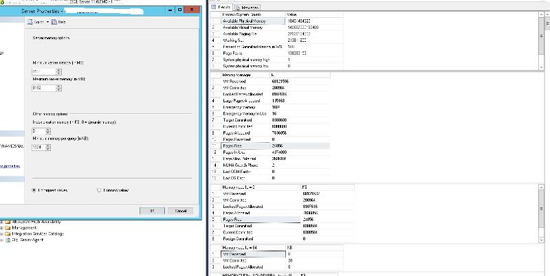

I have an SQL server that is a VM (running in Vsphere) and has 8GB allocated to a database instance. We sometimes encounter performance issues in an application that has databases withing this instance and we want to find out if there are any memory bottlenecks / if we need to look at increasing the memory allocated to the DB instance.
I have run the DBCC memory status command and have attached a screenshot of the results (Main results at the top, there are more figures when I scroll down so I can see if there is a way to export the data if need be) but i'm not sure what the results determine. Please can you point me in the right direction in terms of which column names? & figures to check?

Screenshot now attached (apologies thought id attached before)

Brian CroweDatabase AdministratorCommented:
Instead of regurgitating I thought I would just send you to the source...
https://www.brentozar.com/archive/2013/09/how-to-prove-your-sql-server-needs-more-memory-video/
One of the key indicators you want to look at is your page life expectancy and how it is trending.  If this value is low then your instance is constantly having to get what it needs from I/O instead of from the buffer cache.  If this value is ever-increasing then you have more memory than you need because you essentially have pulled your entire "utilized" database into memory.

Thanks for the feedback. The SQL server has multiple DB instances so I wouldn't wish to just go ahead and assign more memory from the existing 48GB assigned to the VM since different amounts of memory are assigned to difference instances.
Thats why id firstly like to establish if the specific instance in question (this is the one in which the database sit on in which users have seen performance issues) has enough memory and I thought the results provided in the screenshot of the dbcc memorystatus could help determine this but I do not know what columns and what figures i should focus on from the results? and whether the current 8GB allocation for the instance in question is enough. Any guidance / clarification on which columns / figures I need to look for / if the figures look ok is what im asking on this question

Vitor MontalvãoMSSQL Senior EngineerCommented:
You have 16GB RAM in the server and only using half (8GB) for the SQL Server instance. Why's that?
And any special reason to have Min Server Memory = Max Server Memory?
My recommendation is to you to use the following configuration to see if it helps:
Min Server Memory = 0 MB
Max Server Memory = 12288 MB
Let it running with these configurations for some hours with regular activity and then run DBCC MEMORYSTATUS again and compare the new results with old one.
Sorry, you've a VM and I was seeing the Physical Memory information, that is even more than 16GB.
The VM Reserve states the 64GB of RAM.
How many SQL Server instances do you have in that server? They might be fighting for the same resources and that's why you're having the issue. It will be better if you can have a VM for each of those SQL Server instances. For example a 16GB RAM VM per SQL Server instance.
ZberteocCommented:
In that case you would have to determine or appreciate how to distribute the memory between the instances but one think you have to make sure that the total memory they will grab will NOT max out the host memory of 48GB. Firts step I would do is to use the 85% of the 48GB, which is 40GB, and divide it by the number of instances you have on that machine and use that as the max limit on each instance! So if you have 5 instances make sure the max value is 8GB on each of them!
However, no DBCC run on memory will show you what is the actual reason for the bottleneck, that is not what is for! The best way to determine the bottlenecks are the waits statistics and it very well may be the case that the memory is not even an issue. Most of the cases the performance problems come from poorely written queries, bad design on objects, missing indexes or even disk or network latency. All these kind of resources have their own wait types allocated and the time SQL engine is spending on them is constantly summarized since the last start of the SQL service. Those will tell you exactly what are the resources the SQL engine spends the most time on. If it is on the memory or the I/O waits means that increasing the MAX memory limit on that particular instance could help but at the same time you should decrease it accordingly on other instance that doesn't show any kind or at least significantly less of memory pressure. This is a tricky process, is not quite straight forward and needs quite a bit of experience. You should look for materials on the net that talk about the wait statistics on SQL and learn how  to use them.
One place to start learning about wait stats is here:
https://www.sqlskills.com/blogs/paul/wait-statistics-or-please-tell-me-where-it-hurts/
but then you can learn more:
https://www.brentozar.com/sql/wait-stats/
