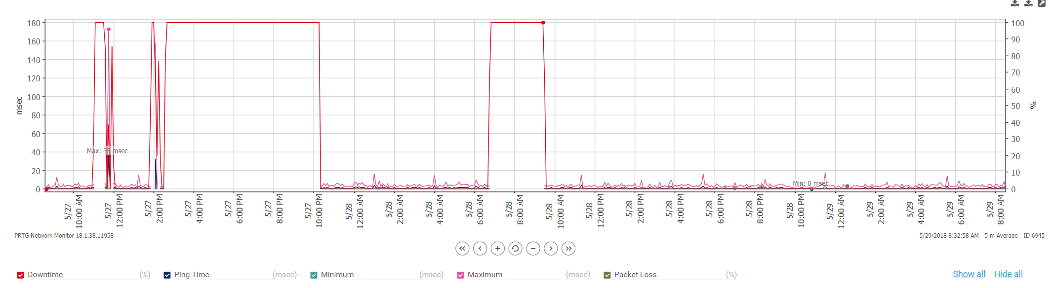

trunk port to other switch just dies
I have a cisco 3750G switch that for some strange reason, all of a sudden my trunk port, that is the link to the other switch just stopped working.
I have restarted the switch, works fine for a few hours and then shut off again.  I don't get any errors in the logs, just dies, any idea how to troubleshoot?
CiscoSwitches / Hubs

I've added the switch in my test bench, so I'll wait to see when it goes down again, to look at the logs
Avatar of Dan
Dan
So I looked through the log and the clock was wrong, so I fixed that, but I don't see anything in there that shows anything about the port going down.

Interesting, thanks for the info, as it's been running for 3 days now with no issues.  Maybe it's time to toss it.
Avatar of Dan
Dan
here's what the logs show, which doesn't seem to show anything really helpful to me, besides the last date, the dates are wrong.

Avatar of Dan
Dan
Here's the log from the other switch, but I don't know why it only has the last 2 days, shouldn't it keep at least a week or more?
This log is useless as well.  It doesn't state why a port goes down, only that it went down.

Avatar of Dan
Dan
Update.  So even with the new, replaced switch, as it's not new switch, it happened again. The port went down for 15 minutes and it came back up again by itself.   This is crazy.
So it happened in the middle of the night, around 5 am, and there's no body there at work.  I will post both of my configs from both switches, and do show logs from both switches and post those as well.  Not sure what else to do to troubleshoot, I guess I can replace the trans receivers on both sides, but I don't see how those can go bad?
Since I don't have Smartnet, I'm not sure how I can get another copy of the iOS?
Avatar of Dan
Dan
I just took some snapshots from my phone of the memory and processor utilization, same with the bandwidth, so it doesn't look like the problem was heavy load.  I'll upload the pictures as soon as I get into work Tuesday morning. I am using PRTG to monitor my network.

Avatar of Dan
Dan
yes, I am using kiwi syslog, I went back since Thursday, which should be enough, since it happened over the weekend.
Here's all the files, let me know if you guys need anything else.
So the problem is happening on c_rack.38 switch, port 28, which is connected to the whub.39 switch on port 50.
Let me know if there's any other info I need to gather?
The memory seems to be high, but maybe that's normal.  The processor has been around 10%, and never higher.
User generated imageUser generated imageUser generated imageUser generated imageUser generated imageAll-Kiwi-Syslog-Server-Events.csv

6/14/2018      7:45:54      Local7      Warning      192.168.100.39      10596: Jun 14 07:45:53.737 pst: %CDP-4-DUPLEX_MISMATCH: duplex mismatch discovered on GigabitEthernet1/0/11 (not half duplex), with T460015655DED40 WAN PORT (half duplex).
6/14/2018      7:44:54      Local7      Warning      192.168.100.39      10595: Jun 14 07:44:53.725 pst: %CDP-4-DUPLEX_MISMATCH: duplex mismatch discovered on GigabitEthernet1/0/11 (not half duplex), with T460015655DED40 WAN PORT (half duplex).
6/14/2018      7:43:54      Local7      Warning      192.168.100.39      10594: Jun 14 07:43:53.721 pst: %CDP-4-DUPLEX_MISMATCH: duplex mismatch discovered on GigabitEthernet1/0/11 (not half duplex), with T460015655DED40 WAN PORT (half duplex).
Avatar of Dan
Dan
aleghart - how would you configure the trunk ports, to ensure that there are no loops?  I don't care if it takes 1 minute for them to come up if the switch is rebooted?
Avatar of Dan
Dan
Thanks guys, I really thank you for all your input, so far,  I replaced the switch, and since then, the port dropped again twice.  Since then I made a few changes, and so far, it's been 2 weeks and no issues, so I'll see what happens.
