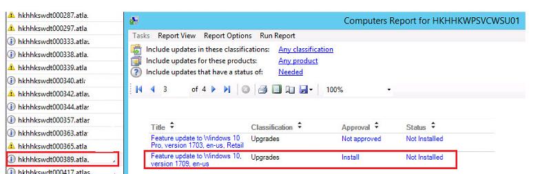

Β  Β  Β  Β  Β  Β I have a WSUS server and already made approval for "feature update to window 10, version 1709, en-us , and when i look at the status report, i see that the client has not yet sent the events have been purged from the server, it been a fews days already, and the status report still remain like this, just wonder is that normal ? how do i get the update install on the window 10 computers ?

below report show specific computer it is pending and last contact is 14 days , total updates 75.

i check the report for the specific computer, this time its shows "not applicable", and looking back to the patches report, the specific computer name no longer appear in the report, do you have any idea ? the specific computer OS Build no is 10240 and version is 1507, do i need the update to version 1607 then 1709 ?

Yes i have seen this before where the version 1507 will not update to 1709. You could manually upgrade it first to 1607 and then attempt the Windows Update to install 1709. Just a FYI, version 1803 is out and is the latest version of Windows 10.
