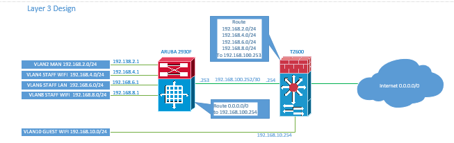

I would like seek for expert advice for my diagram attached ,I am not strong in networking ,our company has purchase new device sonicwall TZ600 ,Aruba 2930F and HP 1950.Please review to the picture I send ,please guide me my question below:
1.For the firewall Uplink in the switch port how do I configure eg .untagged Vlan 100 or 6 and do I need to tagged Vlan ?
2.For the firewall interface which s configure 192.168.100.254 d I need to do anything ?
3.For the downlink and uplink switch to switch what should I configure ? because in cisco I notice that just trunk all and HP is untagged and tagged so which Vlan should I Untagged and tag ?User generated image

Avatar of Benjamin Van DitmarsBenjamin Van DitmarsπŸ‡³πŸ‡±
Why is there twice a staff wifi ?
i would not use an svi for the guest wifi, this network you want tot isolate, and this is not posible in youre design. Β ?
a trunk on hp is an portchannel on cisco.

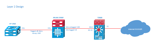

just put on the trunk between the switches all vlan's tagged, you dont need to have an untagged vlan on the connection.
i made you de couple of diagrams, layer 2 and layer 3 design how to beeld what you want.

How large is the space and how many users are there? I'm hoping that the staff wireless VLANs are for two different areas
1) By default the Sonicwall has VLAN1, no matter what you name its subnet. You could just preserve that across all of your equipment rather than have a VLAN 100. To create the other subnets (VLANs) on the Sonicwall, you would create virtual interfaces. Make sure those virtual interfaces are tied to the same interface you're utilizing for your network. That will have the equivalent of VLAN1 being untagged and all of the virtual interfaces being tagged coming out of the Sonicwall.
2) I hope VLANs 4 and 6 are meant for different areas. UNLESS you meant one of those for a purpose other than staff (which you should correct now before building). Also make sure you do not allow VLAN 10 to communicate with the other VLANs. However, you should identify which VLANs should be able to communicate with which. You should also pay attention to your NAT policies. Also.... if you're going to be non-Sonicwall access points, make sure to pay attention to the settings for your zones. You need to specifically disable checks for Sonicpoint devices.
3) Bear in mind Benjamin's last comment. HP switches do not understand Cisco trunks. (Assuming that you will have a Cisco switch in play somewhere, given that you haven't cited an actual Cisco switch)
