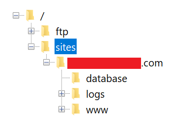

Does having the "Delete all existing files prior to publish" checkbox ticked delete all files in the ftp site path that I assign?
Right now, this is what it looks like when I connect using FileZilla:
I want the database, logs and www folders to go away (I have a backup of these folders anyway). And I think this is what I'll be using
Publish Method:          FTP
Server:                           ftp://www.****.com
Site Path:                       sites/****.com
Destination URL:          http://www.****.com
Is this correct?
Chinmay Patel
Yes. it will delete all the files - or at least try to delete the files in the selected path. I do doubt though if you should target it like this, Ideally you should publish to www folder and leave database and logs as it is.

Ram,
the folder given to you are by your web host, I strongly recommend against deleting them. The logging folder is maintained by your web host - all the IIS logs and other logs(security, error, diagnostic) will be generated and put in that folder by your host. It is also critical when you try to troulbeshoot a live website. Same goes with the database folder. I suggest you leave it as it is and publish under www folder.
Also whatever your current configuration is, I think you will have to use the database interface provided by your webhost i.e. you will migrate data from your database (instead of uploading the file) to your webhosts's database and change your config so that your app can use the proper database.
