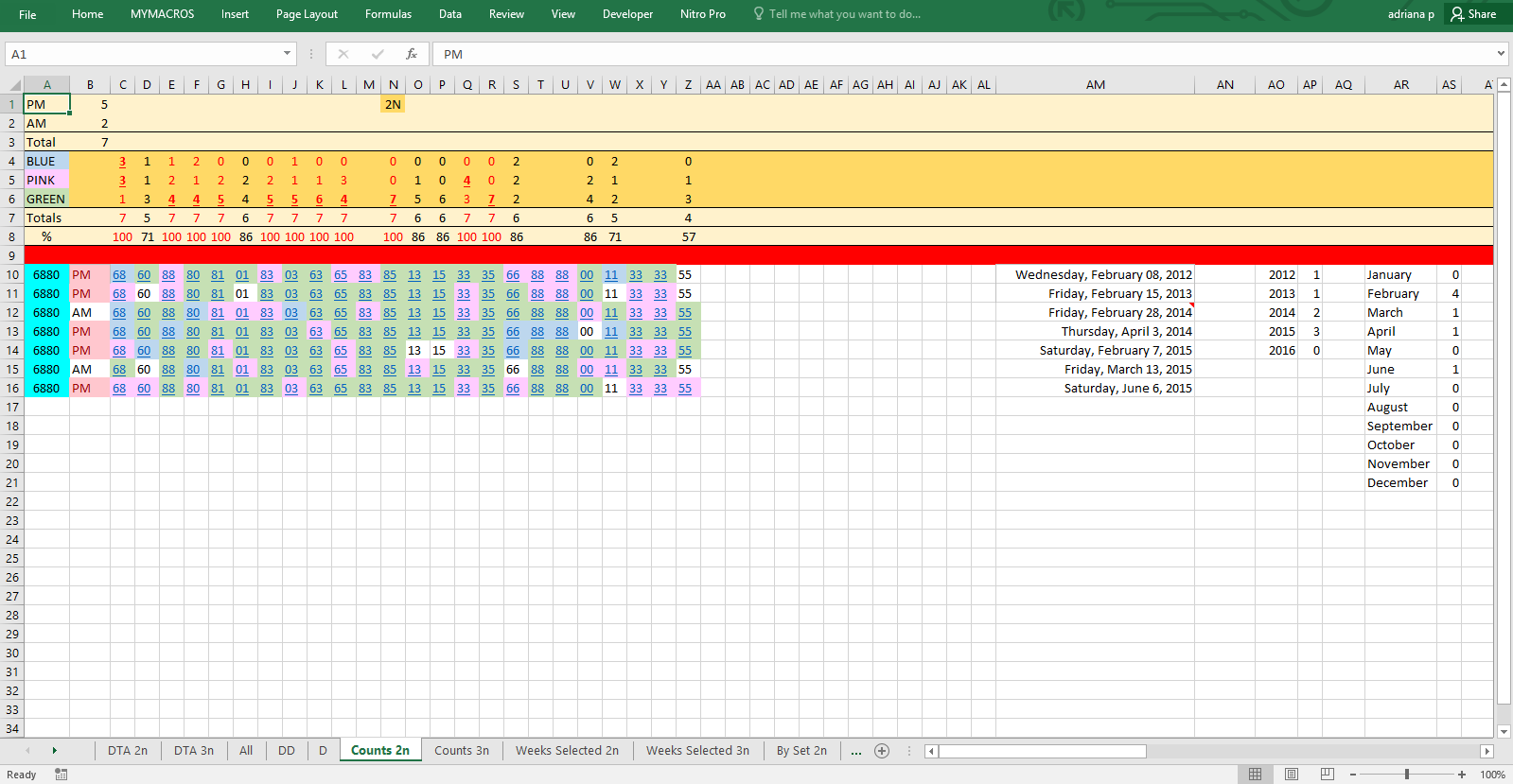

 this the COUNT 2n  sheet needed
ADRIANA P
because is alreday in this file i think was moew easy  create the FAM TRI and FAM DDD here
Martin Liss
No
Just to make sure you understand - that's the result of choosing one ORD value (6880 in the picture).
