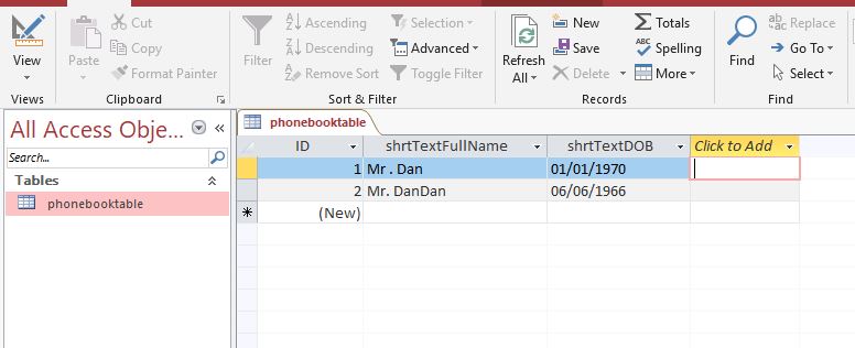

Ok, this code below successfully pulls an specific item from my sample database. Let's use this as our starting point. Attached find the database items and the output of the code.

Fernando Soto
Is the database that you are working with a sample database, one that you can zip it up and upload to where I can download it from. If so please do so.
Maslow Raffo
Yes--here it is (attached).
sample1.accdb
Fernando Soto
Maslow Raffo
OMG IT WORKED!! THANKS SO MUCH!!
(Yes, the DOB in this sample I set to text, but the DOB in the original we were working before was a DTP)
