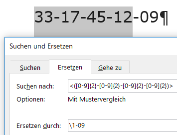

Can't I resrict the search operation to just numbers with the following make-up ##-##-##-## (54-33-22-11), i.e. max of 4 pairs of two-digit numbers.
The current search term would also find numbers such as 54-33-22-11-09

here the graphic that supports my questionrepeated search and replace operations

You might look for a "not hyphen" character instead of ">"
Andreas Hermle
Ah ok, great I got that, thank you very much for your great and professional help.
