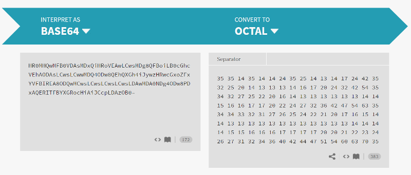

give a couple days to work on this. I believe what your actually trying to do is decode the Base64 to octal values.
Here is an online convertor which shows the output I'm working on for you in vb.net.

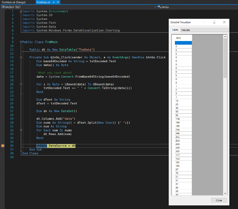

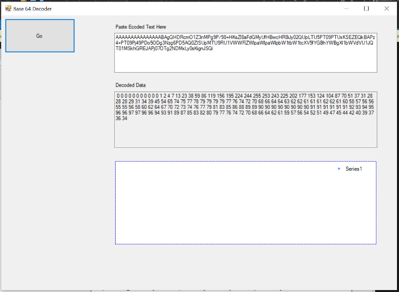

Here is a screenshot of the form with the encoded data that has been decoded and shown in a decoded text field.
and here is a screenshot of the application in debug mode and viewing the contents of the datatable that contains the data harvested from the textbox string.
and finally here is the code from the form
Imports System.Environment
Imports System.IO
Imports System
Imports System.Text
Imports System.Data
Imports System.Windows.Forms.DataVisualization.Charting
Public Class FrmMain
    Public dt As New DataTable("TheData")
    Private Sub btnGo_Click(sender As Object, e As EventArgs) Handles btnGo.Click
        Dim base64Encoded As String = txtEncoded.Text
        Dim data() As Byte
        'What you care about
        data = System.Convert.FromBase64String(base64Encoded)
        For i As Byte = LBound(data) To UBound(data)
            txtDecoded.Text += " " + Convert.ToString(data(i))
        Next
        Dim dText As String
        dText = txtDecoded.Text
        Dim ds As New DataSet()
        dt.Columns.Add("data")
        Dim nums As String() = dText.Split(New Char() {" "c})
        Dim num As String
        For Each num In nums
            dt.Rows.Add(num)
        Next
        chData.DataSource = dt
    End Sub
End Class
