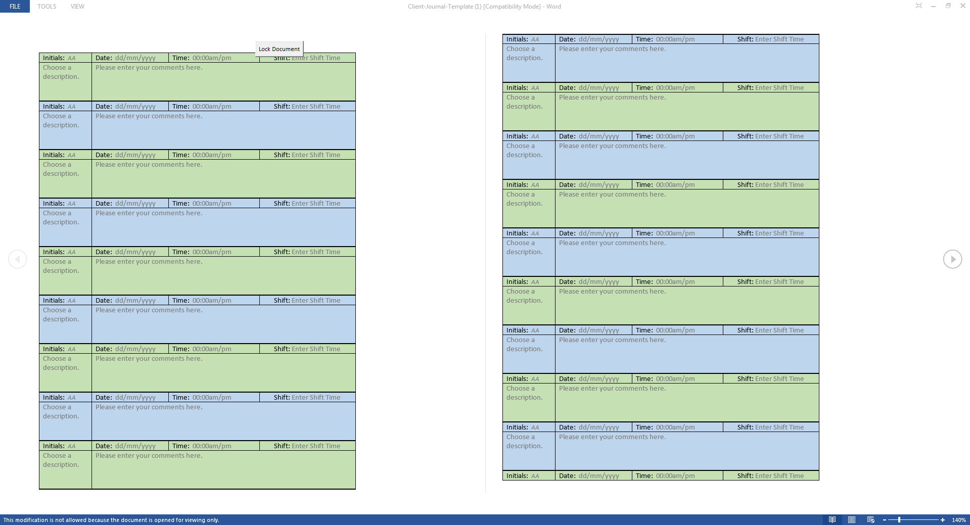

Hmm Im not too sure how to use this coding.  I have attached the document for your viewing. The goal is to have it so once text is added and then the document is locked, then the text can not be changed. If you know a better way to do this then please let me know. Im essentially just trying to make a document dynamically locks information that is imputed. Also, it wants to open in view document. rather than edit? is there a way to have it open ready to be edited?

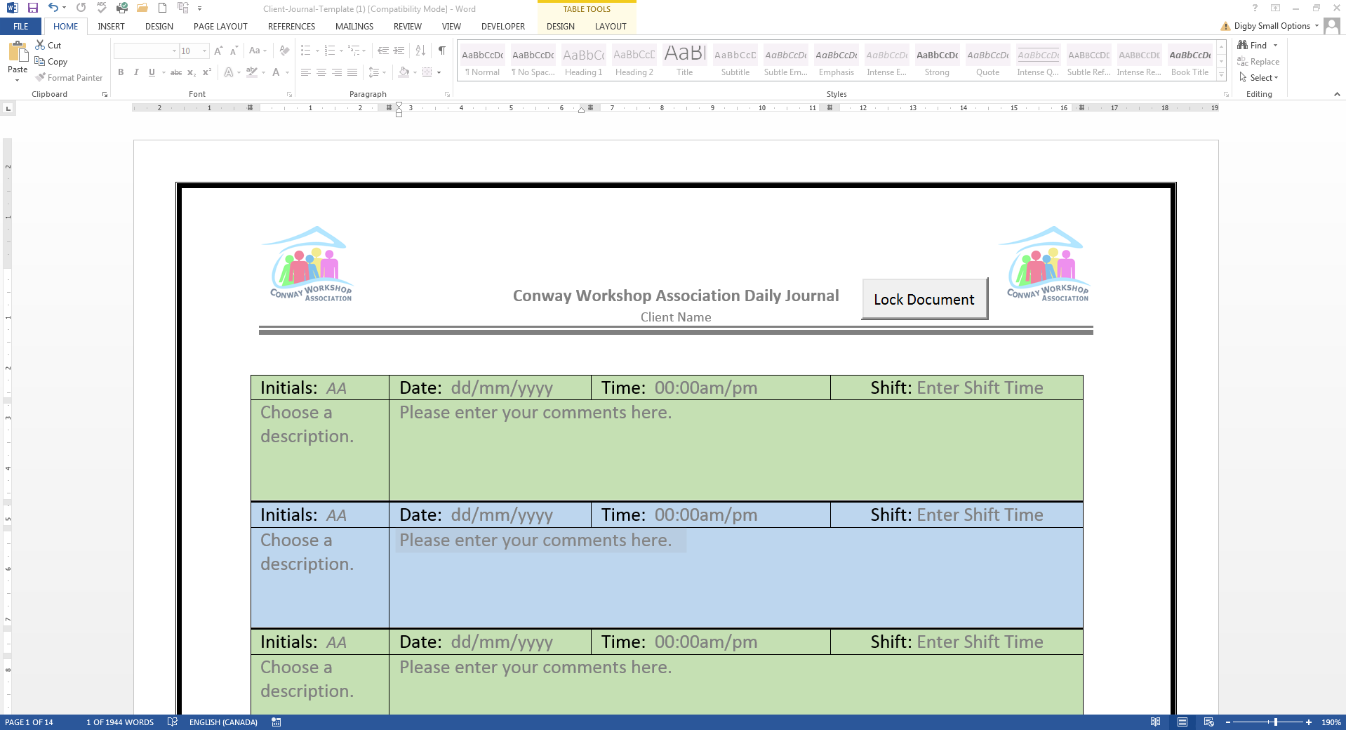

Oh ok I understand now. I know it will be aggravating for them not to be able to edit the document once they lock it but thats how I want it as it because this is part of our legal requirements. I like what you did here but is it possible to have the lock button either follow the page if you scroll down or to put it as part of the ribbon? That way they don't have to scroll up to the top to lock it. Also, with how it opens I would like it to always open in edit mode as my staff will be opening this at least 3 times a day to write their shift comments. So instead of this: User generated image Could we get this?User generated image
