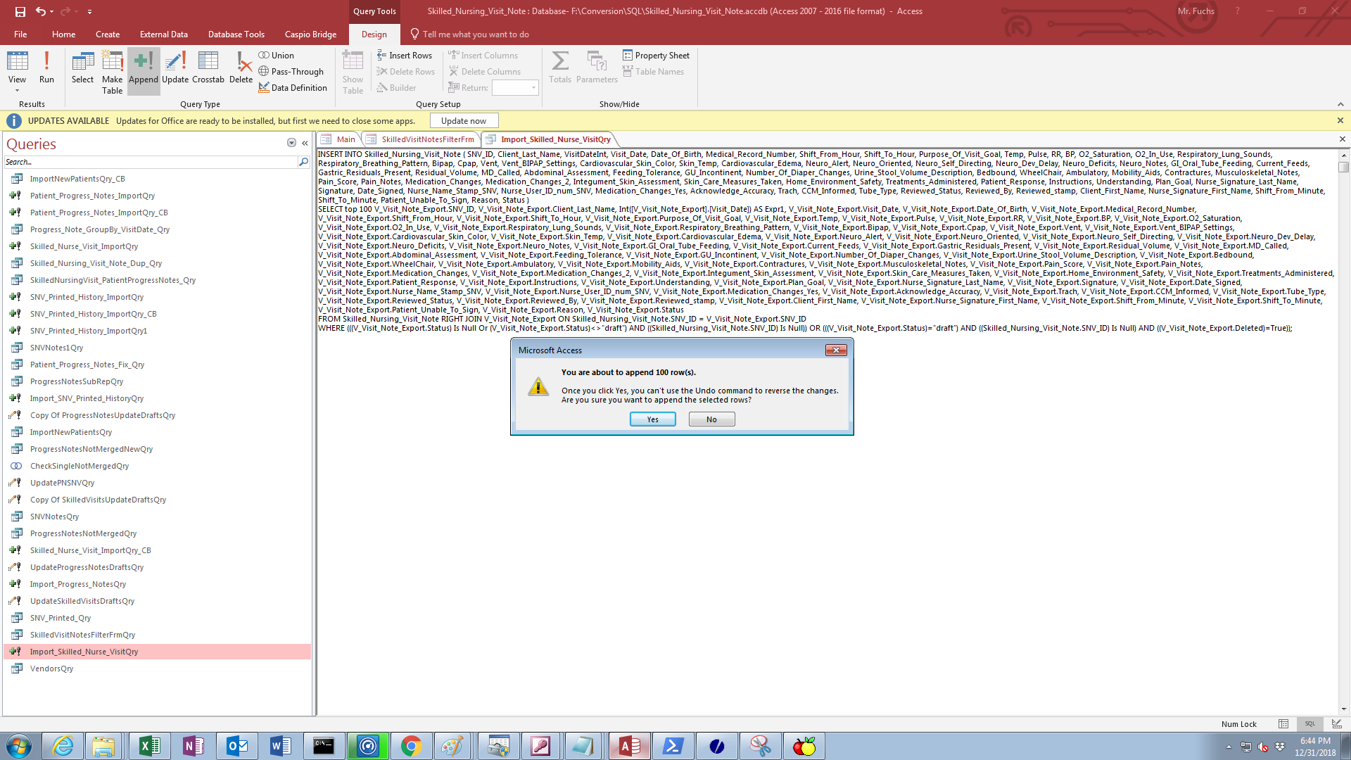

See attached messages that popped up when appending those records.
Then I changed to Top 1000, started with 374, got 427, then 480, then 533.
After that, every time I run, it only appends two records, 537, 539...

If I run for all records, I get "not enough resources..." as in OP.
If I change to top 1000, I get those messages attached, but none of those records are getting thru...
