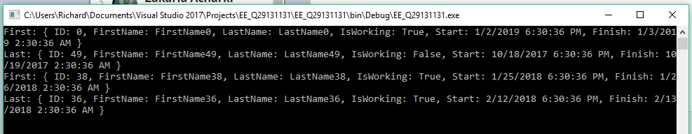

Here is one potential way:

Which produces the following output -Capture.PNG-saige-

Produces the same output as above.
