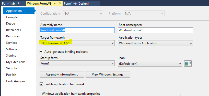

Check your projects properties first:
When you need .NET 2.0 as destination target, then you need to select it there.
