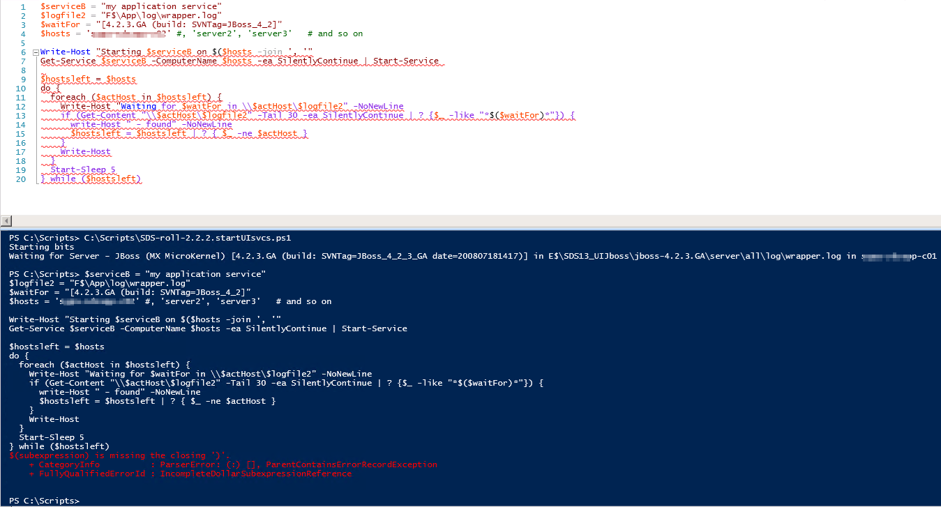

Here is the new output. It seems to be crying about a missed closing. Can you please advise when you spare a moment?
subexpression missing the closing ')'.
Qlemo
Darn paste errors ...
Lines 6 and 7 need to be
Write-Host "Starting $serviceB on $($hosts -join ', ')"
Get-Service $serviceB -ComputerName $hosts -ea SilentlyContinue | Start-Service
Robert Perez-Corona
Thanks! The message is now gone. However, for some reason, the Tail doesn't seem to be picking up the $waitfor variable. It's almost as it is being ignored. However, when I modify the string and remove some of the brackets to leave it like so: "4.2.3.GA (build: SVNTag=JBoss_4_2_3_GA date=200807181417)]"
..it works. Perhaps this is due to one of the methodologies regarding the regex mentioned earlier by oBdA. I might be able to use it like that. Thanks again for the big help. I will now test with multiple servers at the same time.
Works with the first bracket removed. This screenie was performed with the bracket in place.

I was hoping to ask one last thing from this script. I'm willing to start another thread since this is a wish list item. However, would it be possible to append the "found" hosts to the title bar?
For example, every time the string is found on the remote host, append the host name to the console title so that we can easily see which hosts have been found.
Although it already displays found and the host name in the command output, it is moving quick so it's hard to reference a row while it's scrolling.
Thanks!
Qlemo
I really would do that differently: Only output found hosts, and kind of a progess info on a single line.
$serviceB = "my application service"
$logfile2 = "F$\App\log\wrapper.log"
$waitFor = "[4.2.3.GA (build: SVNTag=JBoss_4_2]”
$hosts = 'server1', 'server2', 'server3'   # and so on
Write-Host "Starting $serviceB on $($hosts -join ', '"
Get-Service $serviceB -ComputerName $osts -ea SilentlyContinue | Start-Service
$hostsleft = $hosts
do {
  foreach ($actHost in $hostsleft) {
    Write-Host "`rWaiting for $actHost                   " -NoNewLine
    if (Get-Content "\\$actHost\$logfile2" -Tail 30 -ea SilentlyContinue | ? {$_ -like "*${waitFor}*"}) {
      write-Host " - found"
      $hostsleft = $hostsleft | ? { $_ -ne $actHost }
  Start-Sleep 5
} while ($hostsleft)
The last line always shows some "changing" info just to be sure the script really does something, and starts a new line whenever it found the search pattern on another server.
