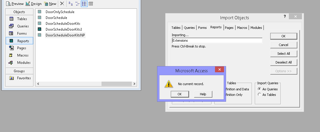

I was just importing all front end objects into a new Blank DB and got this error. Anyone seen this before? All files are on a local pc with no association with any server.  .User generated image
Then after clicking OK I got thisUser generated image
Then I got thisUser generated image
Then this User generated image

These are signs of database corruption typically.
I'd try the undocumented SaveAsText and LoadFromText.
You could also try using John Viescas' FixBroken utility found at http://viescas.com/category/links/downloads/
Always work off of a copy of your db in case anything goes awry.
