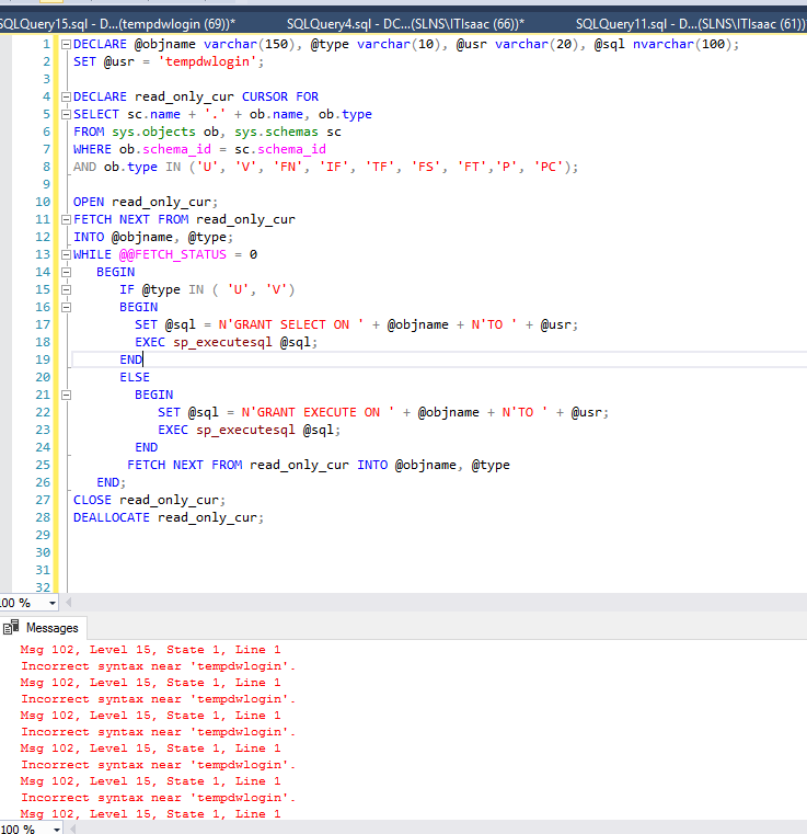

DECLARE @objname varchar(150), @type varchar(10), @usr varchar(20), @sql nvarchar(100);
SET @usr = "tempdwlogin';
DECLARE read_only_cur CURSOR FOR
SELECT sc.name + '.' + ob.name, ob.type
FROM sys.objects ob, sys.schemas sc
WHERE ob.schema_id = sc.schema_id
AND ob.type IN ('U', 'V', 'FN', 'IF', 'TF', 'FS', 'FT','P', 'PC');
OPEN read_only_cur;
FETCH NEXT FROM read_only_cur
INTO @objname, @type;
WHILE @@FETCH_STATUS = 0
BEGIN
IF @type IN ( 'U', 'V')
BEGIN
SET @sql = N'GRANT SELECT ON ' + @objname + N'TO ' + @usr;
EXEC sp_executesql @sql;
END
ELSE
BEGIN
SET @sql = N'GRANT EXECUTE ON ' + @objname + N'TO ' + @usr;
END
FETCH NEXT FROM read_only_cur;
END;
CLOSE read_only_cur;
DEALLOCATE read_only_cur;
SET @usr = 'tempdwlogin';
OPEN read_only_cur;
BEGIN
BEGIN
SET @sql = N'GRANT SELECT ON ' + @objname + N'TO ' + 'tempdwlogin';
END
ELSE
BEGIN
SET @sql = N'GRANT EXECUTE ON ' + @objname + N'TO ' + 'tempdwlogin';
END
FETCH NEXT FROM read_only_cur INTO @objname, @type
END;
OPEN read_only_cur;
BEGIN
BEGIN
END
ELSE
BEGIN
END
END;
use master;
SELECT *
FROM sys.sysusers
WHERE name like 'MyTest%' ;
go
create login MyTestLogin with password = '123MyTestLogin123';
go
create user MyTestUser for login MyTestLogin;
go
use EE;
go
GRANT SELECT ON dbo.tmpempid TO MyTestLogin;
go
-- the above fails with the same error as you get.
--Msg 15151, Level 16, State 1, Line 58
--Cannot find the user 'MyTestLogin', because it does not exist or you do not have permission.
-- Need to assign permissions to USER
GRANT SELECT ON dbo.tmpempid TO MyTestUser;
go
-- now clean up the testing
use master;
go
drop user MyTestUser;
go
drop login MyTestLogin;
go
try:
