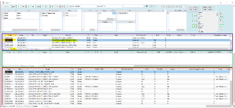

I have a subform and I can click the model and another form will display the records for that model. I have saved the record number of the model that works but the subform returns back to the first record.
I would like to go back to the record.
Me.[FrmTclientBatch].SetFocus
DoCmd.GoToRecord acDataForm, "me.FrmTclientBatch", acGoTo, 2
This code doesn't work, I've tried variations and it either says the form is not open or that it doesn't recognise the field.
Ive put record 2 here hardcoded but that will be a variable later.

I used your method all I had to do was save the pk of the record and then use your method to find it, works perfectly thank you.
Me.abiCode.SetFocus
SaveCode = Me.abiCode.text
Dim rst As DAO.Recordset
Set rst = Forms![Form1].FrmTclientBatch.Form.RecordsetClone
rst.FindFirst "abiCode='" & SaveCode & "'"
If Not rst.NoMatch Then
  Forms![Form1].FrmTclientBatch.Form.Bookmark = rst.Bookmark
Else
  MsgBox ("Not found")
End If
