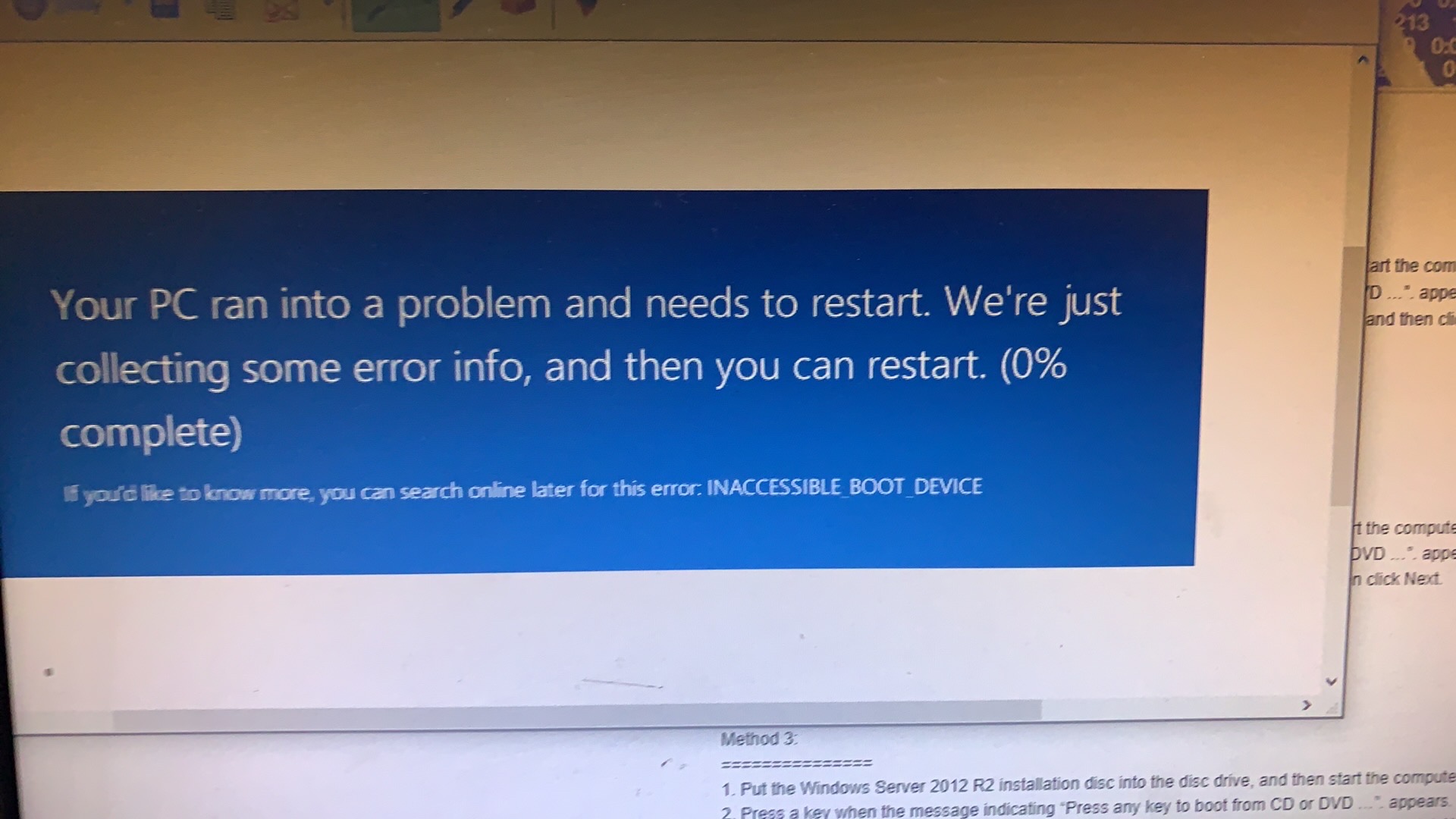

I have a Server 2012 R2 (as a VM on Esxi) that’s been running for years without any problems and suddenly I get BSOD.
It’s the infamous inaccessible boot device.
I can access the drive without any issues via boot disks, checked disks in disk part, tried offline registry to check the LSI drivers has right start values.
We’ve also removed a load of pending and installed rollups without any luck.
Any ideas? I have had this a number of times on Windows 10 but a restore to system restore point fixes it.. but don’t have that in a server.

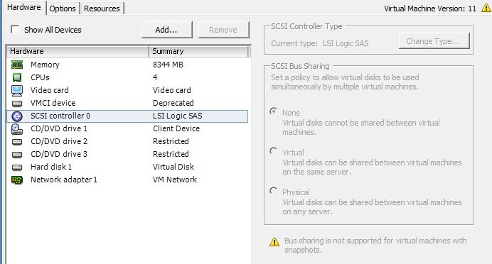

I can get to the BIOS but that doesn't really offer much....we've tried changing the vmware SCSI controller from LSI Logic SAS to Parallel but nothing happens.
