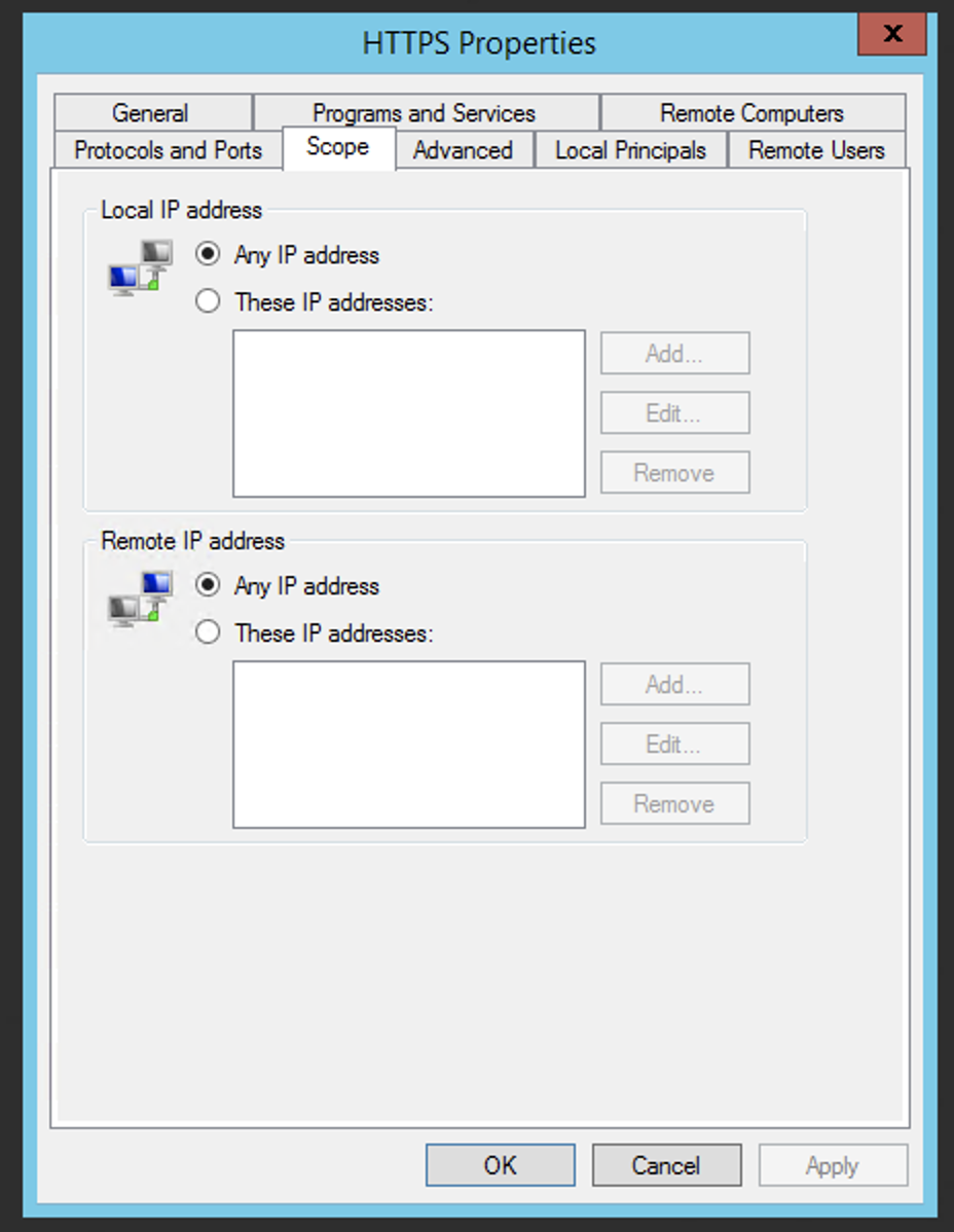

It sounds like you didn't do your inbound Windows firewall properly. Can you please post a screenshot of the rule you created?
William Peck
Henrik Rosager Pedersen
I've just made a simple rule opening port 443.
Sk-rmbillede-2019-12-18-kl.-08.03.33.pngSk-rmbillede-2019-12-18-kl.-08.03.45.pngSk-rmbillede-2019-12-18-kl.-08.03.53.pngSk-rmbillede-2019-12-18-kl.-08.04.04.png
