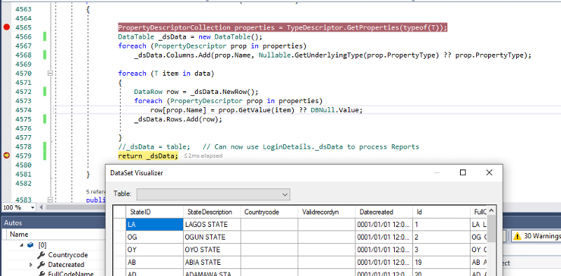

The First step    CreateDataSet2();
actually fills the dataset _dsData  ( see dataset  set with data below  )
Dataset   _dsData Loaded with Data

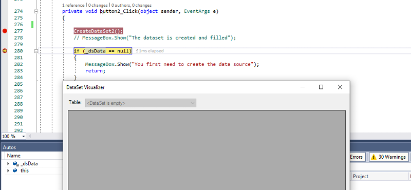

When i tried to to read _dsData from a different method
the debbugger show that _dsData is empty  (see  screen below)
Dataset Empty  Why ??
Why is there no Data  in _dsData because I am trying to read the
data from a method different method from where i created the dataset

you surely have _dsData define at more then one place (which is not really good when you can avoid id).
Your line 277 should read:
_dsData = CreateDataSet2();

It is really hard for us just with snippets and screenshots to see the full scopes of your variables.
By default, your variables should always have the smallest scope possible. For example, if your _dsData is not used anywhere else then in the button2_Click event handler, it should be declared only in that scope. You will avoid a lot of issues.
