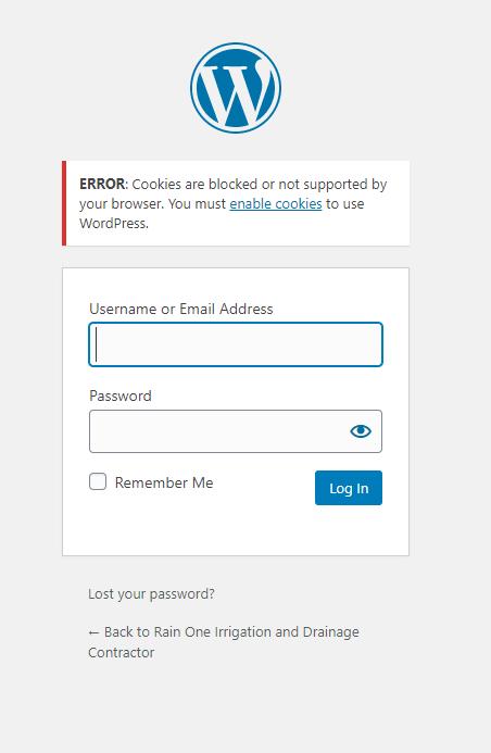

I ran the duplicator, then installed on new location, everything went fine until I got to logging in through wp-login.php. It produces the attached, which of course is total crap, the from site works perfectly in Chrome as do many other sites that require Cookies.
How do I get around this?

Have you tried forcing a refresh of the page (ctrl-F5 in Chrome or FF) ?
Richard Korts
Thanks Terry.
The host suggested using https (the site is secure) and that worked.
Odd that we don't have to do that for the live site.
Terry Woods
Ha, I was just writing a comment to suggest that! Glad you got it solved :-)
