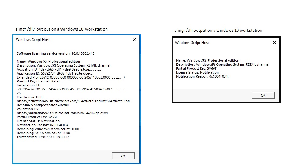

Avatar of lianne143lianne143🇺🇸
Hi
Please find the attached result of slmgr /dlv and slmgr /dli  that i ran on one of the Windows 10 workstation.
Also on my Microsoft Volume licensing center , i do have the KMS key for Windows 10.
Avatar of Mike TaylorMike Taylor🇬🇧
Hi, The output clearly shows the OS is retail and does NOT match the KMS key. Use a retail key for KMS or the key for W10 PRo.
