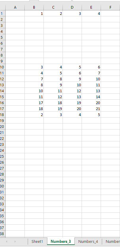

The picture I posted shows the last few combinations in the numbers_3 group, after running the script. The script should continue until the 60’s and end with 70 in the last cell to the right. This means the code is not making all of the combinations that are possible.

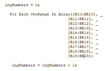

When create sets in 29173484a.xlsb changing the ranges to look like this
  For Each vntRange In Array([B10:AX10], _
                             [B11:AX11], _
                             [B12:AX12], _
                             [B13:AX13], _
                             [B14:AX14], _
                             [B15:AX15], _
                             [B16:AX16], _
                             [B17:AX17], _
                             [B18:AX18], _
                             [B19:AX19])
it produces Numbers_3, 4, 7, 8, 10, 11, 17, 18, 3 sheets and I get this so I don't know what's going on.
