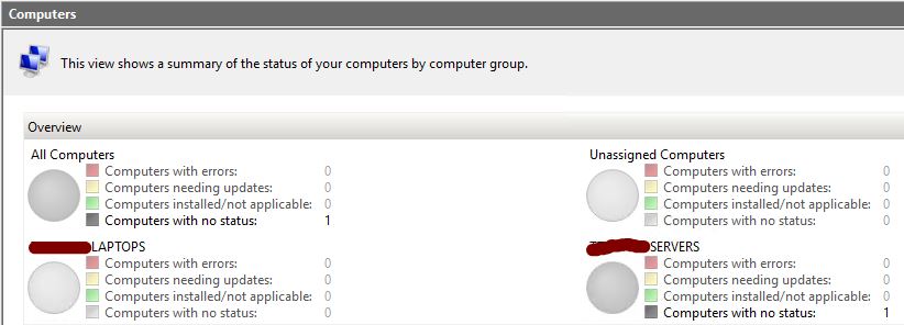

Is the filter set to Any?
Can you provide a screenshot of the group where you are supposed to see computers?
Can you click on "Computers" and share a screenshot of "Overview"?

Yes set to Any, I have attached screenshot, only one computer is showing, status of it is not reported.
