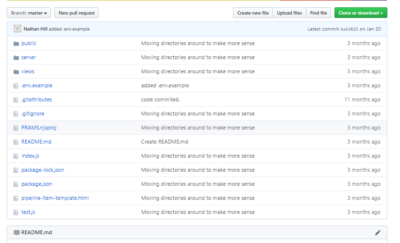

Here's "master." This is the original body of code that we all branched off of as part of our collective effort to clean things up...
master branch
