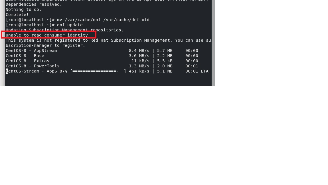

tried both dnf clean packages and dnf clean all , still the same thing!

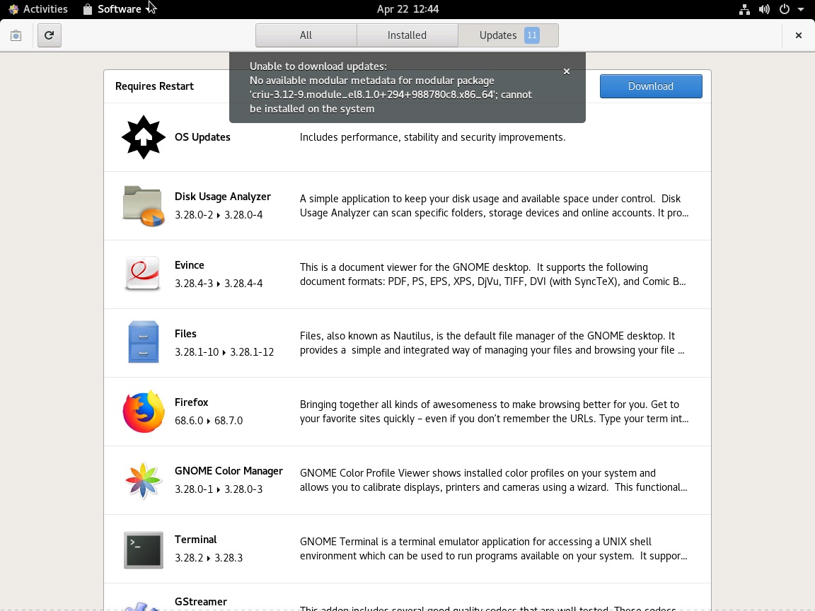

I also found CentOS apps update page has this:
software updates failes
marrowyung
mv /var/cache/dnf /var/cache/dnf-old
try dnf update again
still can't !
and for the CentOS app store for any system update I can't download and the error is :
app store
I tried to yum the package I highlight and the download of package doesn't work.
same cache message!

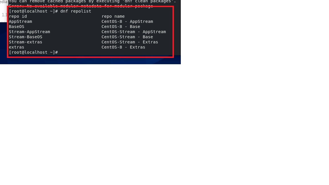

Joe Woodhouse
What is the output of running
dnf repolist
cat /etc/yum/pluginconf.d/product-id.conf
cat /etc/yum/pluginconf.d/subscription-manager.conf
If you have "enabled=1" in either of those files, edit them to make it "enabled=0" instead.
Suggest you also repeat renaming the cache folder and once you've done that, run "dnf clean all" again.
marrowyung
dnf repolist
dnf repolist
no such file

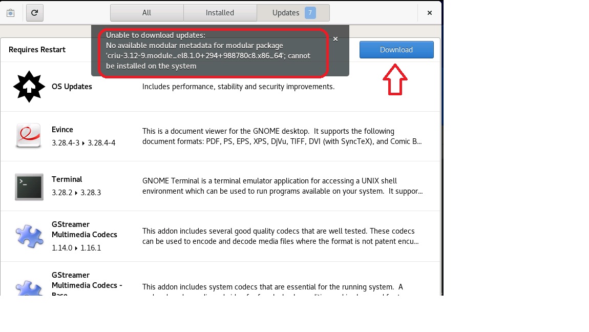

do you see what the error message on the GUI when I go to apps store? is it means anything to you ?
Joe Woodhouse
No. My CentOS VM has never had this problem in over a year of frequent use.

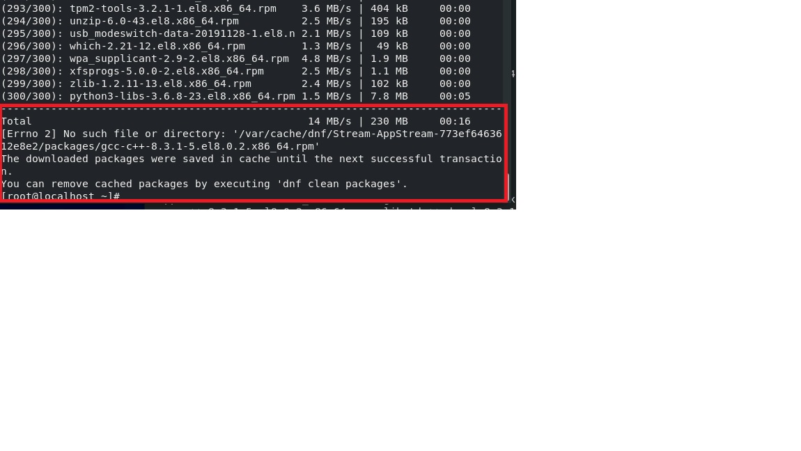

marrowyung
dnf update
dnf update

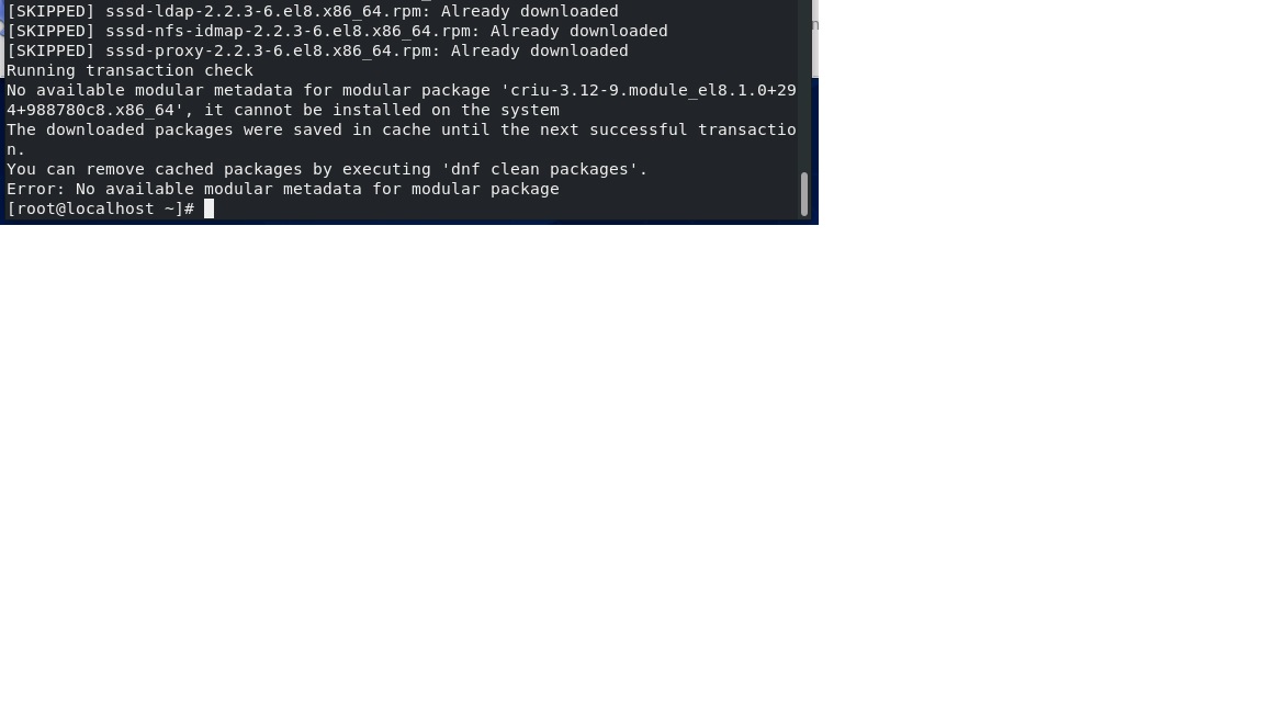

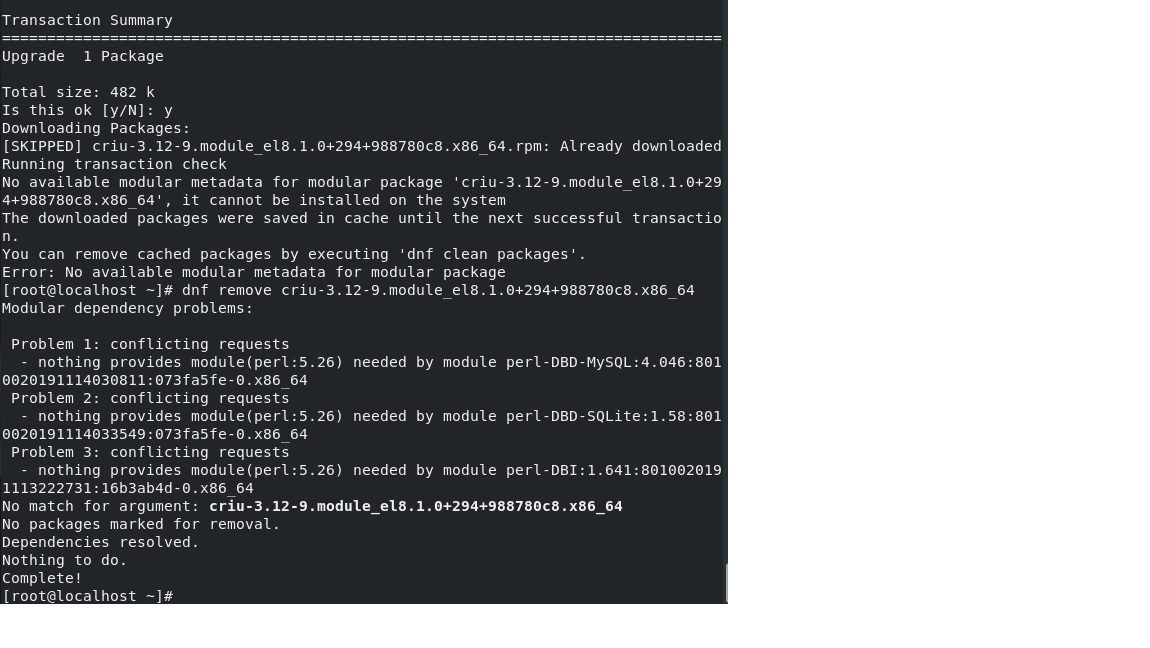

marrowyung
seems can't remove that package:
can't remove package
William Peck
Joe Woodhouse
Yeah that looks like you've pulled down only some of what you need. Normally that happens when someone just copies a repo and tries to install from that, but from your repolist earlier you're picking up all the centos repos correctly.
At this point it looks like an issue with that rpm specifically - your yum/dnf is doing exactly what it should when it finds a repo in module format without everything it needs to install the module.
You'll need someone smarter than I am to fix this one, sorry.
