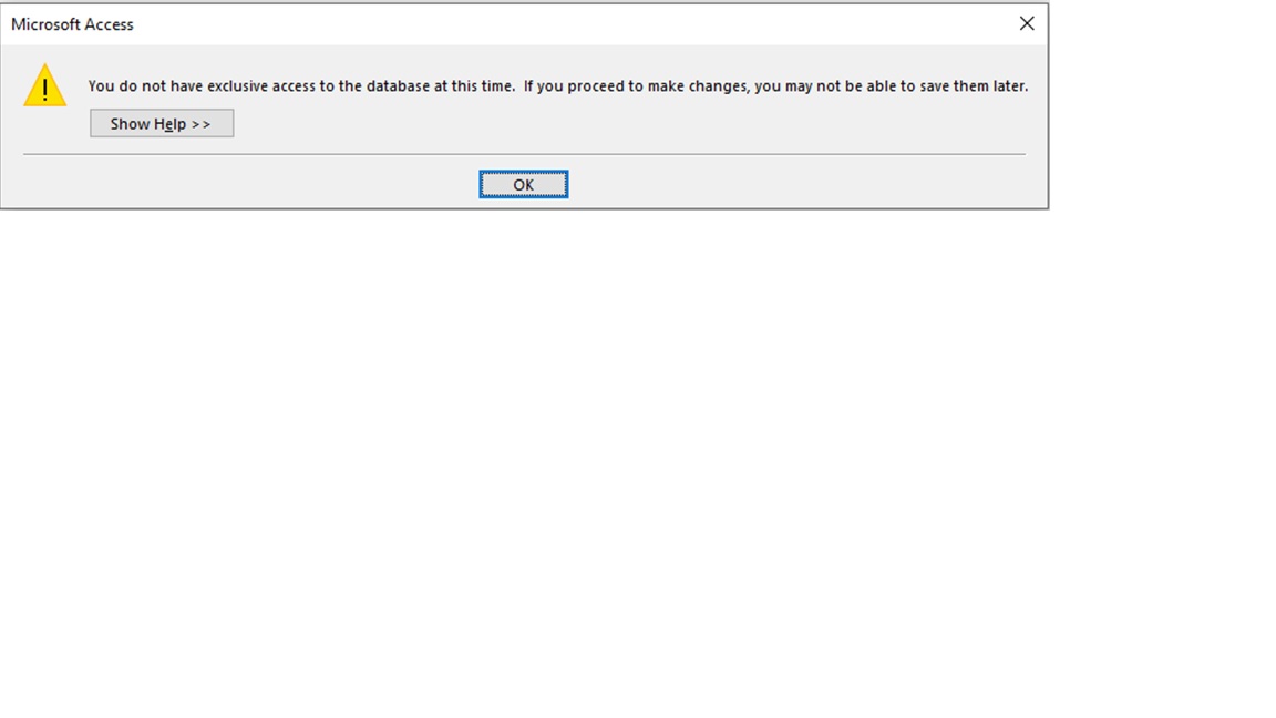

If at any point while I have the database open I run a test on some logic and then try to make revisions I get this message
After I get the message I have to reboot the machine to get the ability to revise the application back.

As gustav said, it's whatever you are doing as part of the test.
From Access's standpoint, it see's more than one connection to the database, so it says that you do not have exclusive access.
One way to do that would be to open the same DB with two separate instances of Access. It doesn't care that they are running on the same machine and are by the same user. It only sees two connections to the database.

And BTW, one of the reasons you may have never have hit this before is that this behavior was changed.
Up until Access 2000, the VBA project within the DB was not monolithic and it was possible for multiple users to make code changes at the same time.
Starting with Access 2000, that was no longer true. Now the VBA is monolithic and only one user at a time can make code changes.

Thanks for your input. I still don't know exactly what was causing the issue.but I did revise the way I was testing and got through my changes. I don't have the luxury of time right now to play with this enough to pinpoint the cause but if I figure it out later I'll post the result.
